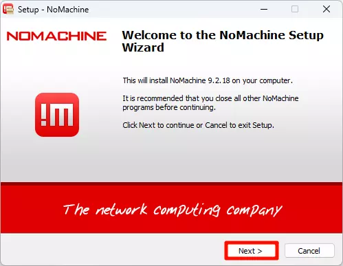

2. Welcome Screen
Click Next to proceed to the next step.

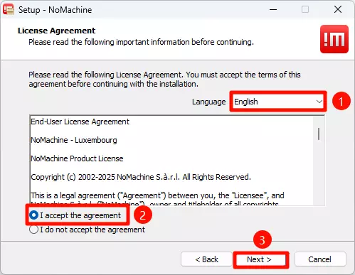

3. Language and License Agreement
Select your preferred language and accept the license agreement, then click Next to proceed.

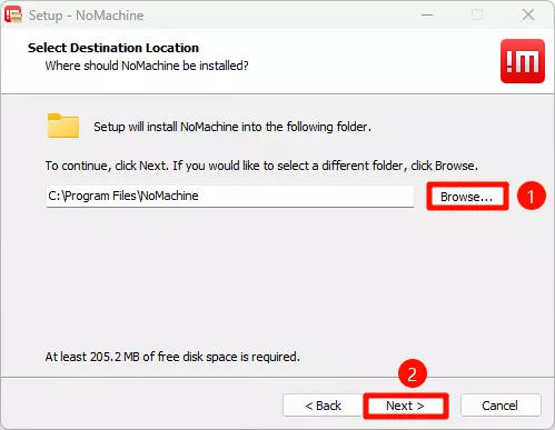

4. Choose Installation Location
It is recommended to select the default installation location, then click Next to start the installation.

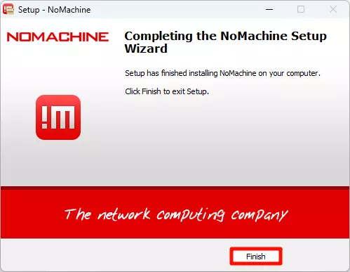

6. Complete Installation
Click Finish to complete the installation.
After installation is complete, you need to restart the system.

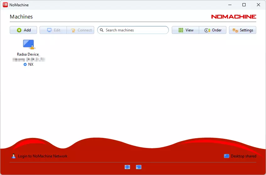

  1. Open the NoMachine software on your PC
  2. The software will automatically scan for NoMachine devices on the same local network
  3. Find the corresponding Radxa board device and click Connect to establish the connection

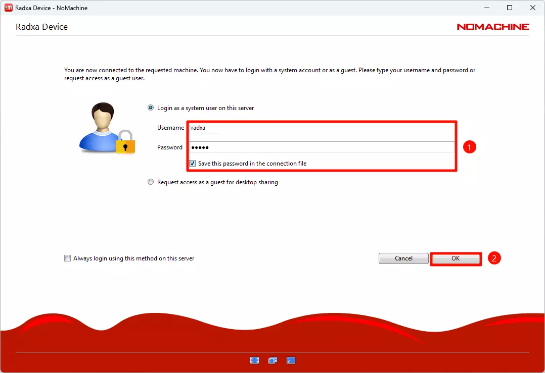

Login to System​
Enter the username and password of the board, then click OK to login.

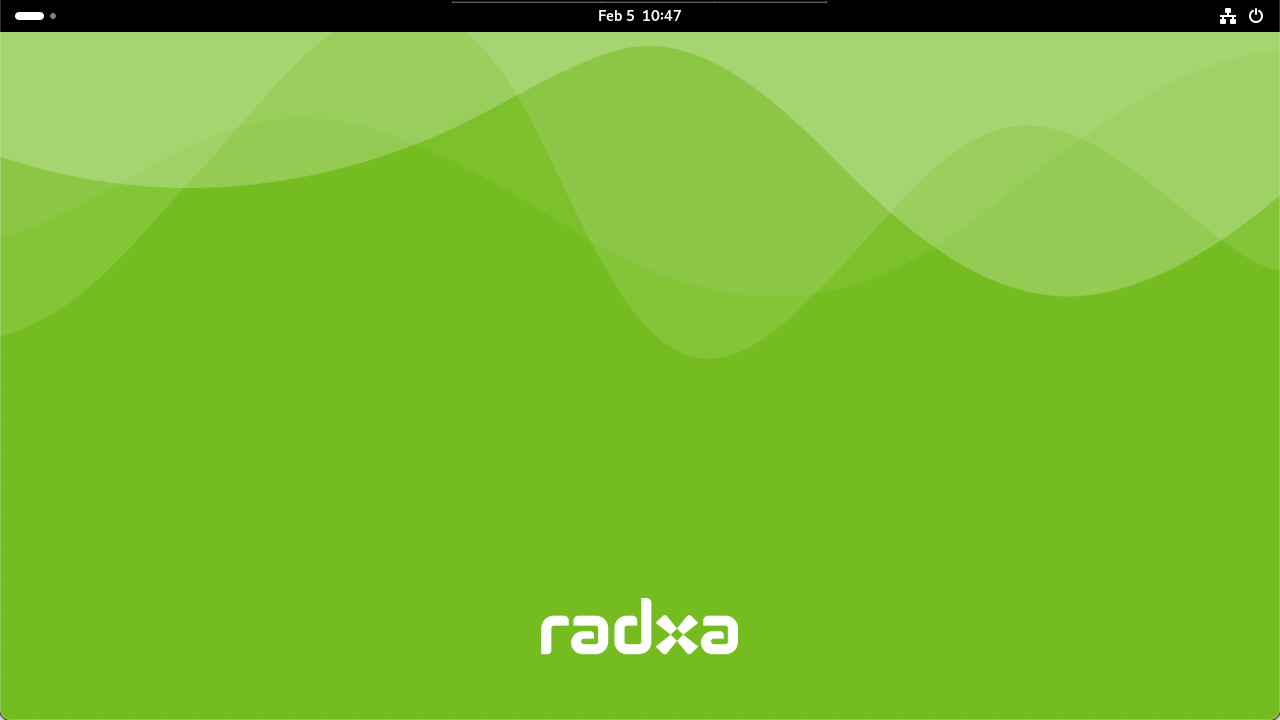

Remote Desktop Connection Successful​
After successful login, a NoMachine window will pop up on your PC, displaying the desktop environment of the Radxa board. You can now remotely control the board.
