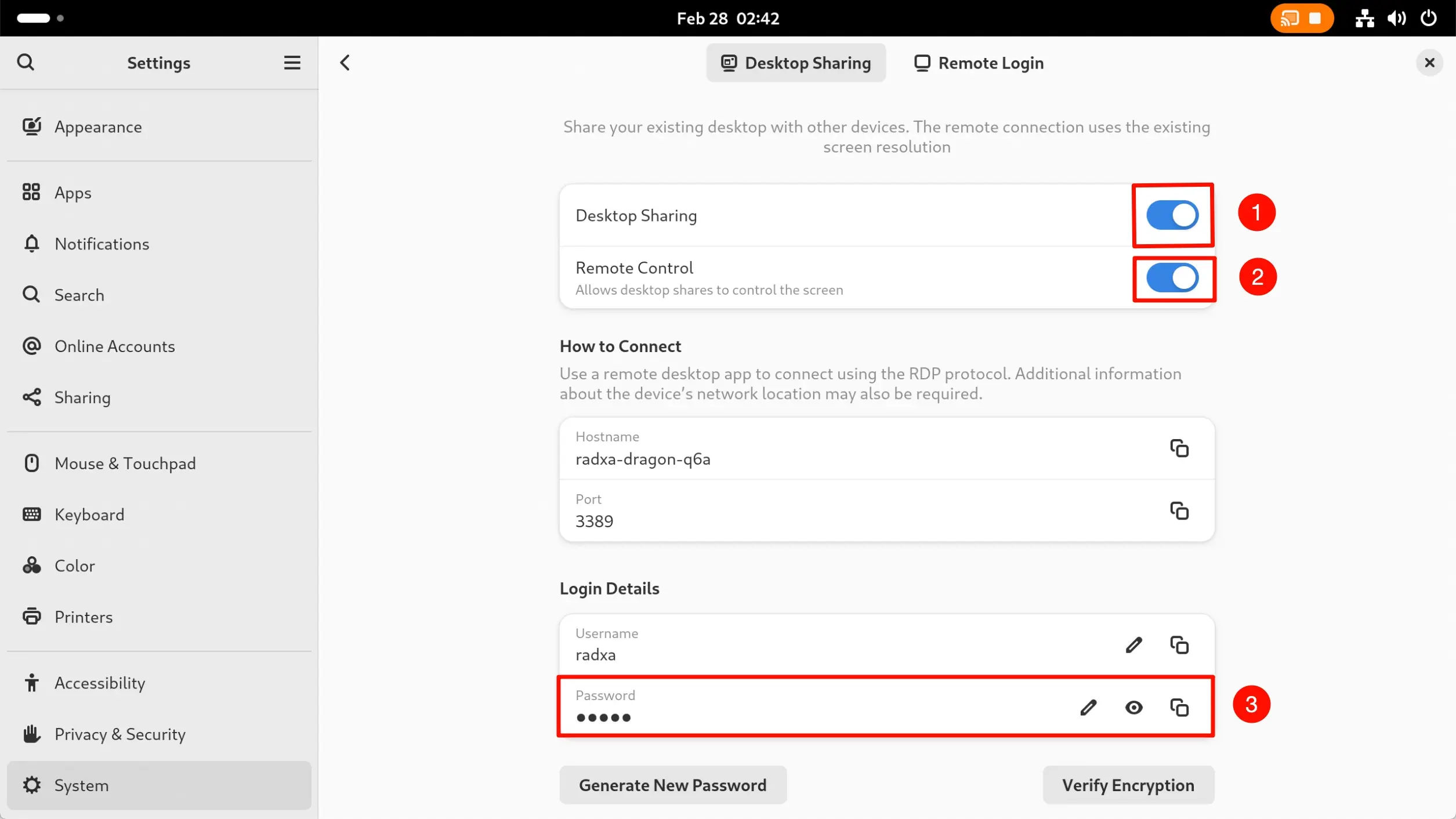

Enable desktop sharing​
Go to Settings --> System --> Remote Desktop --> Desktop Sharing, and enable desktop sharing.
① : Enable desktop sharing
② : Enable remote control
③ : It is recommended to reset the remote login password
Port
The default port is 3389. If you change the port, you must specify it when connecting.
Example: if the port is set to 6666, enter 192.168.11.100:6666 when connecting.

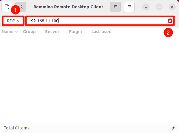

Configure RDP (PC)​
After configuring the RDP service on the board, you can remotely control it from Windows / Ubuntu / macOS.
RDP remote login​
RDP remote login
  • Windows: use Remote Desktop Connection.
  • Ubuntu: use Remmina.

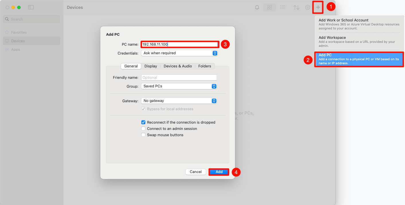

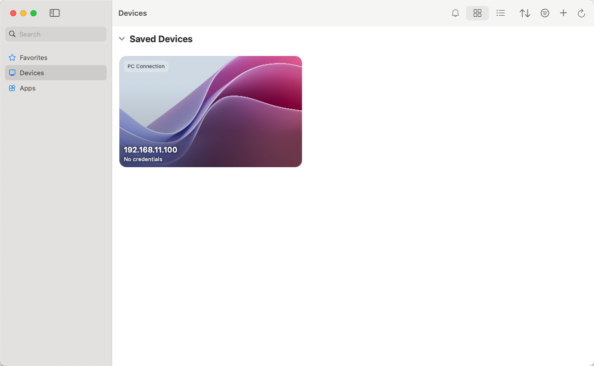

  • macOS: use Microsoft APP.
  • Open the remote desktop tool

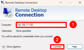

Windows usually includes Remote Desktop Connection. Search for Remote Desktop Connection in Windows.
Open Remote Desktop Connection, enter the board IP address, and click Connect.
① -> Enter the board IP address
② -> Click Connect

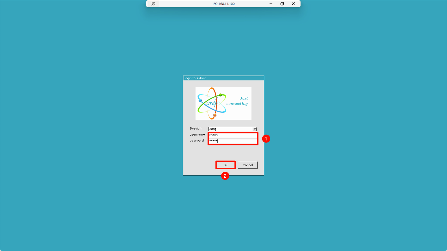

  • Enter user information
Enter the board system username and password, then click OK.
① -> Enter username and password
② -> Click OK

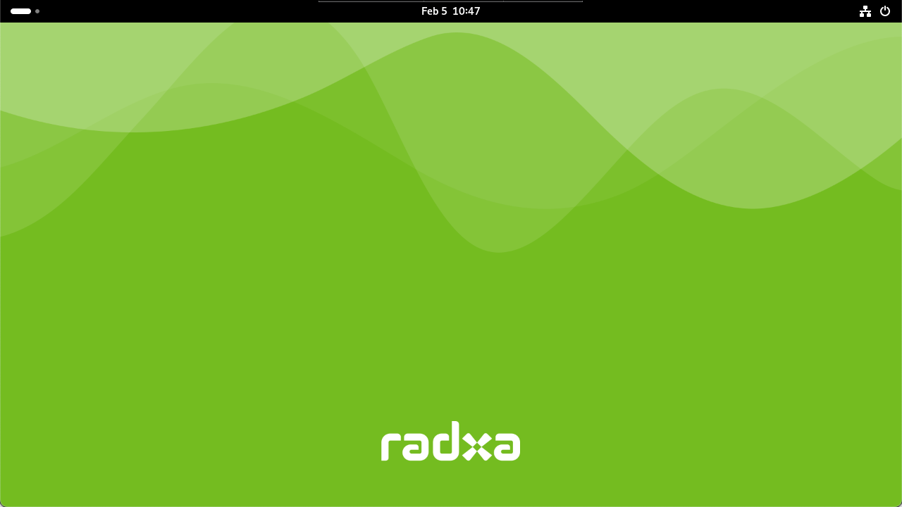

Remote login successful​
After connecting successfully, you will see the board desktop.
