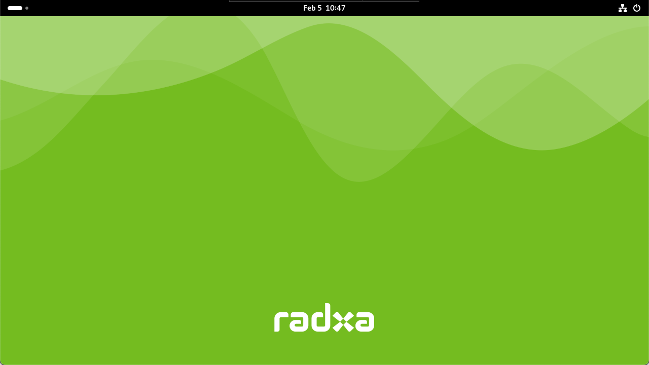

VNC Remote Login​
Open VNC Viewer on another device and connect using the board's IP address and port.
① : Enter the board's IP address and port
② : Click Connect to address ··· to connect to the board
① : Enter the VNC password
② : Check Remember password to save the password for next time
③ : Click OK to connect
VNC Black Screen
If the VNC session shows a black screen, check whether auto-login is enabled. If it is enabled, disable auto-login.
