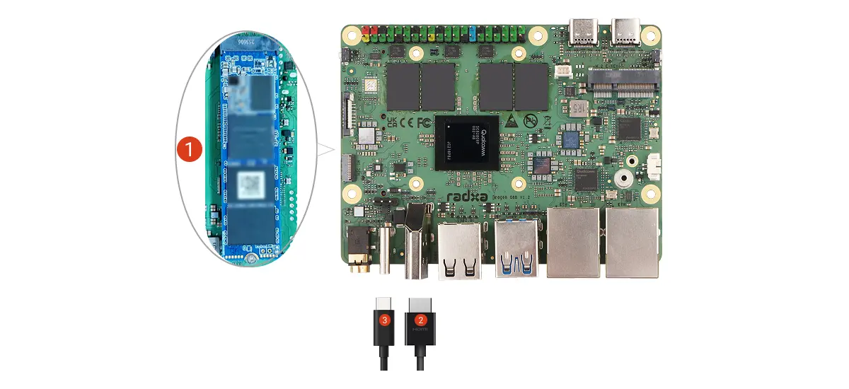

After installing the system, install the NVMe SSD into the Dragon Q8B NVMe SSD slot, then power the Dragon Q8B with a 20V Type-C power adapter to boot the system.
  1. Install the NVMe SSD
  2. Connect the monitor and board using HDMI or a dual-ended USB-C cable
  3. Power the Dragon Q8B with a 20V Type-C power adapter
After the system boots normally, the power LED turns green and the status LED blinks blue.
