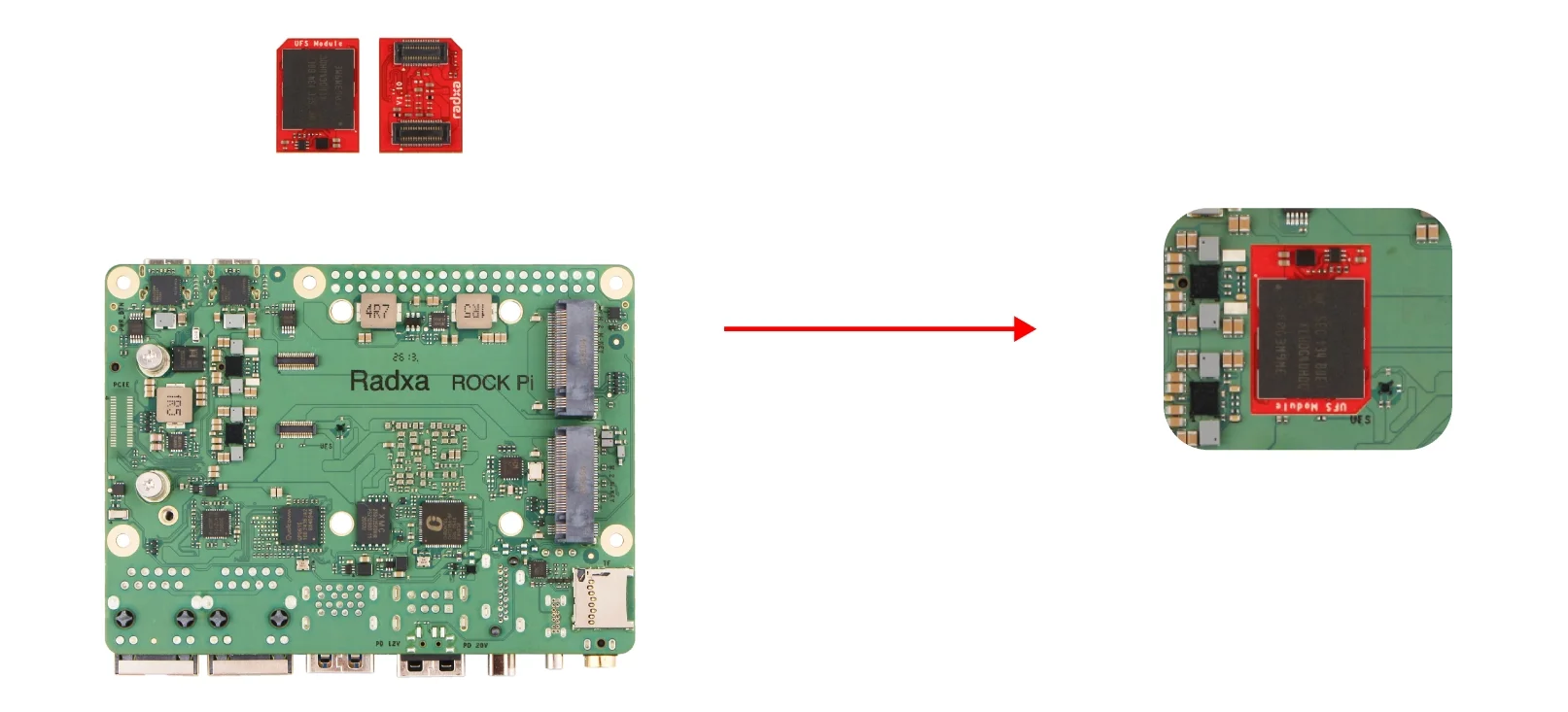

UFS Module Installation Steps:
  1. Observe the notch direction on the UFS module and the notch marking on the board's UFS module interface to determine the correct installation orientation.
  2. Place the UFS module above the board's UFS module interface, ensuring the UFS module interface is properly aligned with the board's UFS module interface.
  3. Gently press one end of the UFS module until you hear a "click" sound, indicating successful installation. Then press the other end in the same way to ensure the UFS module is properly installed.
