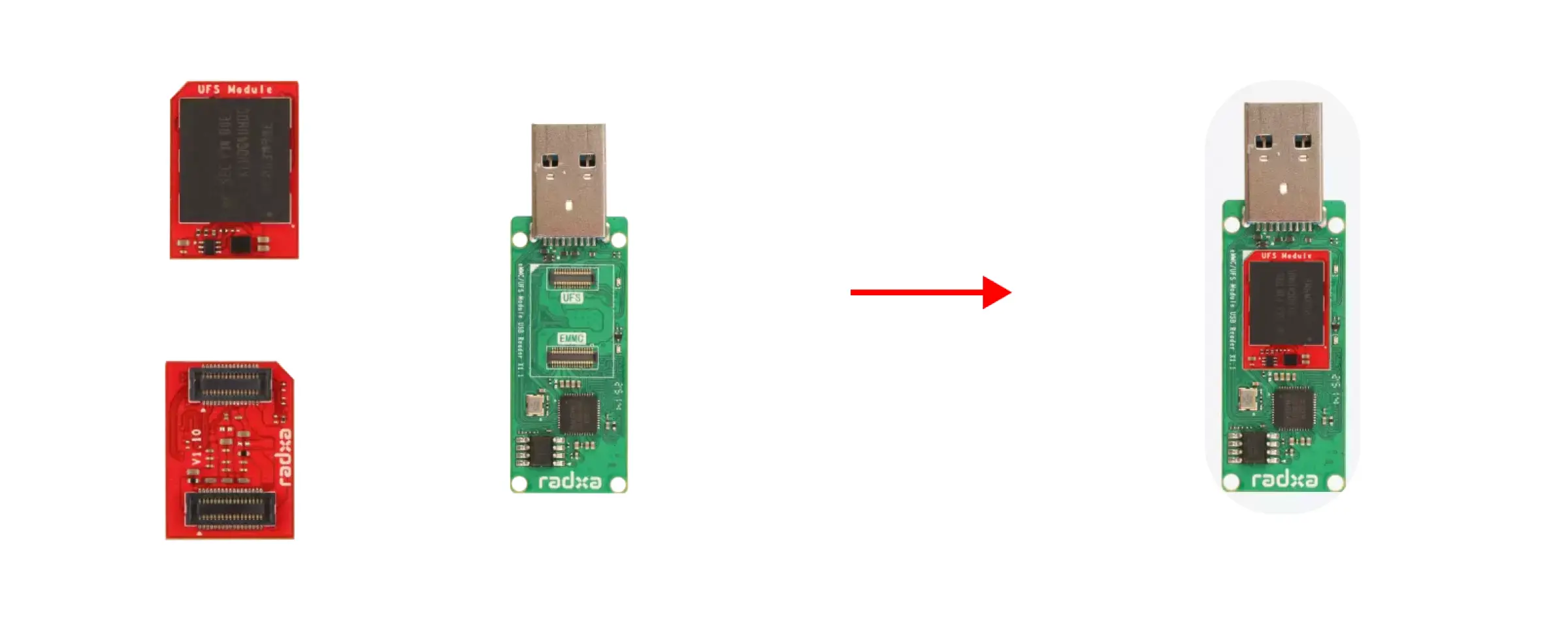

Insert the UFS module into the Radxa eMMC/UFS module reader, then connect the module reader to your computer.
caution
UFS Module Installation Steps:
  1. Ensure the notch on the UFS module aligns with the connector on the module reader
  2. Make sure the slot interface at the bottom of the UFS module aligns with the connector on the module reader
  3. Gently press down on one end of the UFS module until you hear a "click" sound, then repeat for the other end to ensure the UFS module is properly installed.

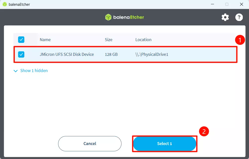

Select Storage Device​
Click the Select target option and choose the UFS module device.

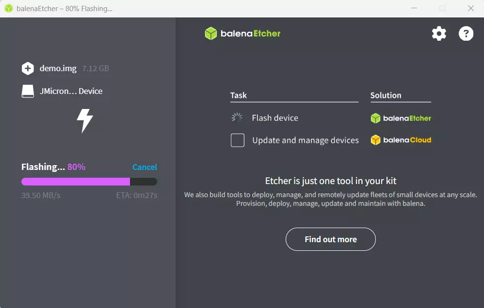

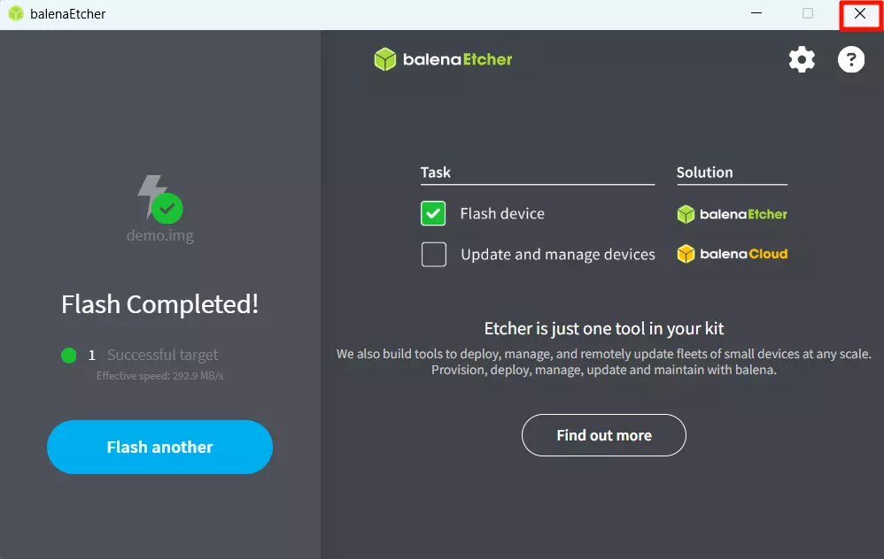

Start Flashing​
Click the Flash! option to start flashing the system image to the UFS module.

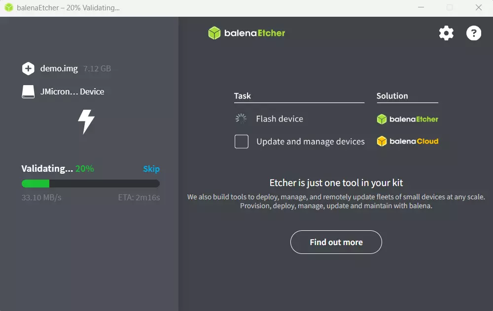

Waiting for system installation to complete
Waiting for system verification to complete
After successfully installing the system image, close the Etcher software!

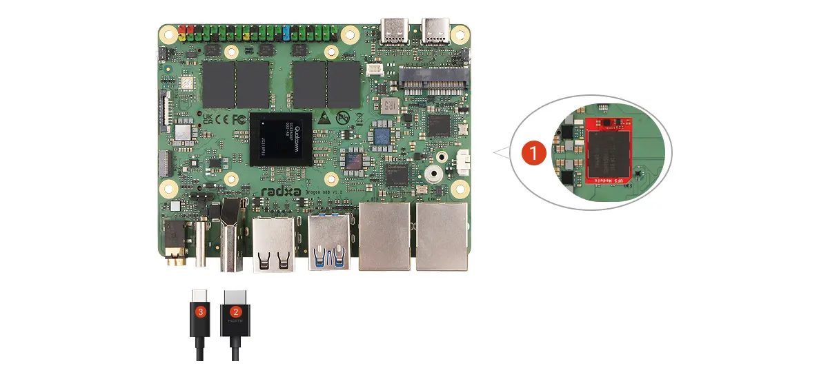

After installing the system, install the UFS module into the Dragon Q8B UFS module connector, then power the Dragon Q8B with a 20V Type-C power adapter to boot the system.
  1. Install the UFS module
  2. Connect the monitor and board using HDMI or a dual-ended USB-C cable
  3. Power the Dragon Q8B with a 20V Type-C power adapter

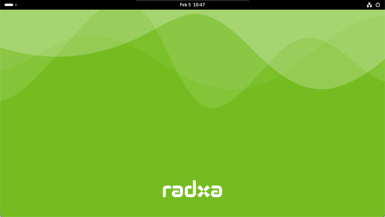

After the system boots normally, the power LED turns green and the status LED blinks blue.
System Login​
When you boot the system for the first time, log in with the default username and password.
The default credentials for Radxa OS are:
ItemValue
Usernameradxa
Passwordradxa
Using the System​
After the system boots successfully, you can start using Radxa OS on the Dragon Q8B. For basic Radxa OS usage, refer to Use the System guide.
