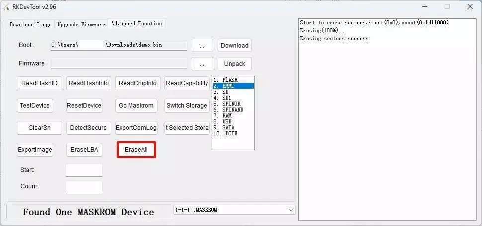

Use the RKDevTool utility to erase the eMMC.
Before using the tool, ensure your PC can recognize the device in Maskrom mode, then follow these steps:
- Open RKDevTool
Make sure the host can detect the Maskrom device and select the advanced options.
- Write the Loader
Go to the Resource Download page to download the appropriate Loader file, then modify the Boot option to select the downloaded file.
- ① : Select file path
- ② : Download Loader file
- ③ : Operation feedback information
- Read Storage Capacity
Select the ReadCapability option to read the current device storage capacity.
- Erase eMMC
First select EMMC, click Switch Storage to switch the storage, then click the EraseALL option to clear the eMMC contents.
- Reboot the System
Click the ResetDevice option to restart the device.
