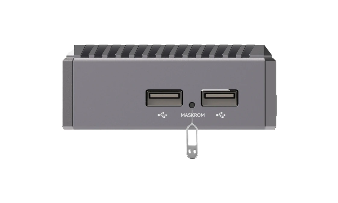

E54C has a dedicated Maskrom button, as shown in the image below:
MaskRom Key

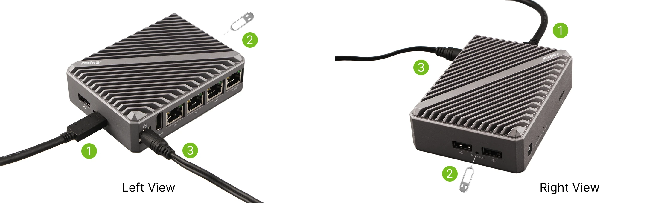

Prepare the following equipment:
  • A USB Type-C cable
  • A small pin or toothpick
  • 12V DC power adapter
MaskRom Key
  1. First, plug the USB Type-C cable into the E54C's USB Debug port, and the other end into your computer
  2. Then press and hold the Maskrom button with the pin
  3. Then plug in the 12V DC power adapter
Under normal circumstances, the device will enter Maskrom mode, the power indicator light will turn on, and you can release the pin.
