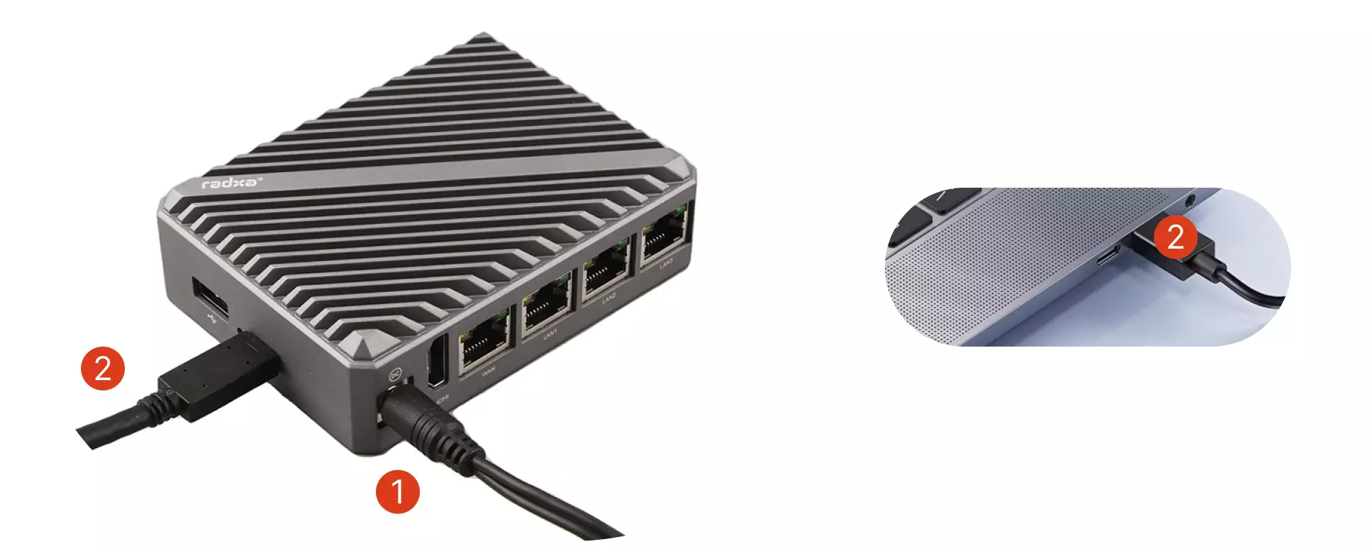

Hardware Connection
① : Power on the motherboard using a power adapter
② : Connect the motherboard's Debug port to your computer's USB port using a USB Type-C cable
