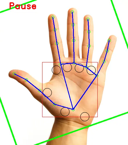

  • Example result: output.jpg is written in the sample directory
output image
