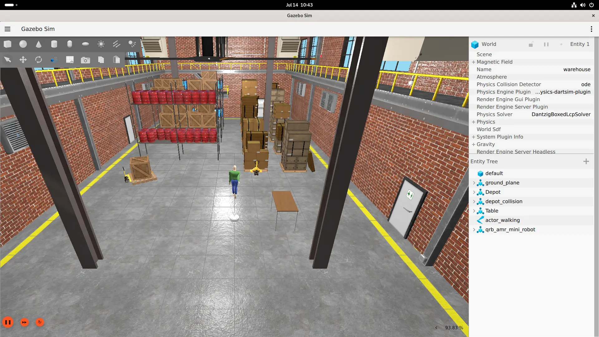

Terminal 1: Start Gazebo Warehouse Follow Scene​
Run from the desktop terminal:
radxa@airbox$
ros2 launch qrb_ros_sim_gazebo gazebo_robot_base_mini.launch.py \
world_model:=warehouse_followme_path2 \
rgb_camera_config_file:="$HOME/qrb_ros_samples/robotics/simulation_follow_me/followme_rgb_camera_params.yaml" \
enable_laser:=false enable_imu:=false enable_depth_camera:=true
Gazebo starts paused. Click the play button at the bottom-left to start the simulation.

The AMR should be visible in Gazebo following the moving actor. The controller publishes nonzero /cmd_vel (up to approximately linear.x = 0.396 m/s, angular.z = -0.310 rad/s).
