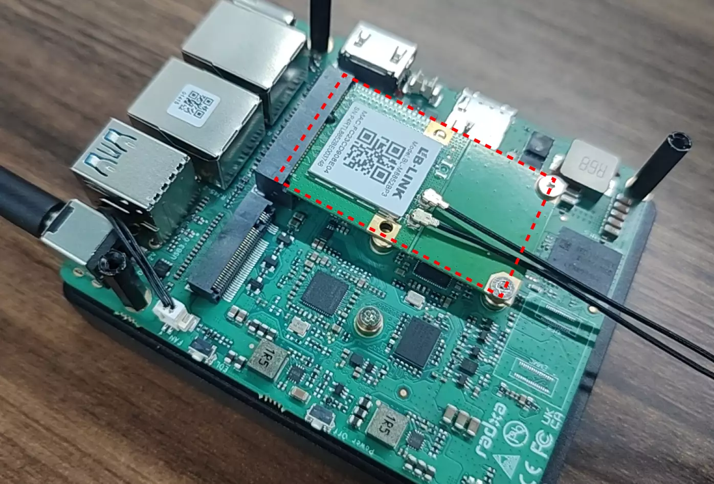

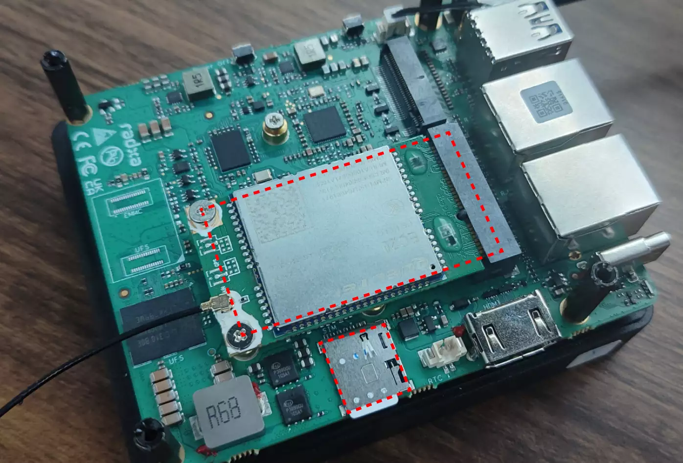

Hardware Connection​
After powering off the motherboard, insert the Mini PCIe wireless network card or 4G/5G module into the Mini PCIe slot, then secure it with an M.2 screw.
