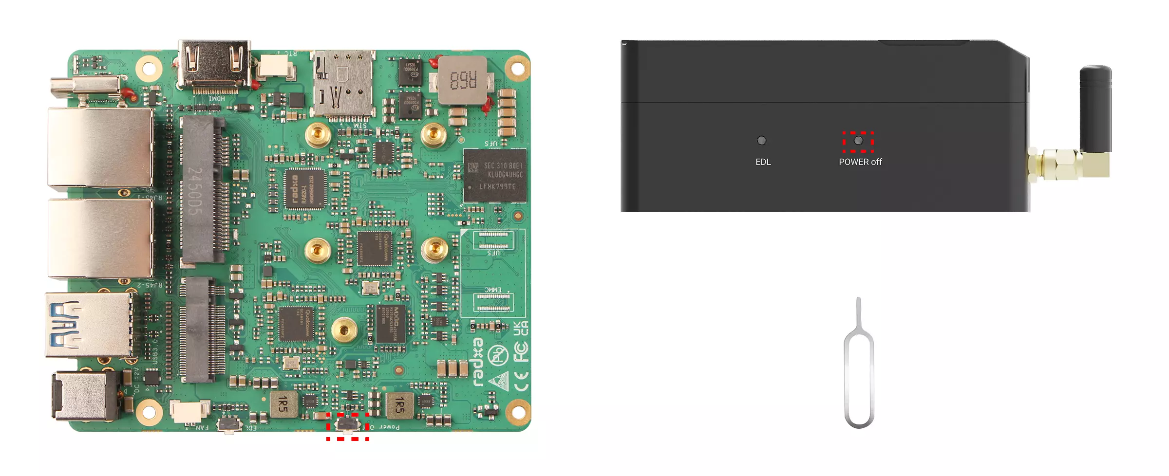

Power Button
The Radxa Fogwise® AIRbox Q900 features a built-in power button for system shutdown control.
User Guide​
When the AIRbox Q900 is powered on, briefly press the power button to display the system shutdown option. If no action is taken within 60 seconds, the system will automatically shut down.
Note: After shutdown, you must unplug and reconnect the power adapter before powering on again.
If the AIRbox Q900 is installed in a metal enclosure, you can use a pin, toothpick, or similar tool to press the power button.
