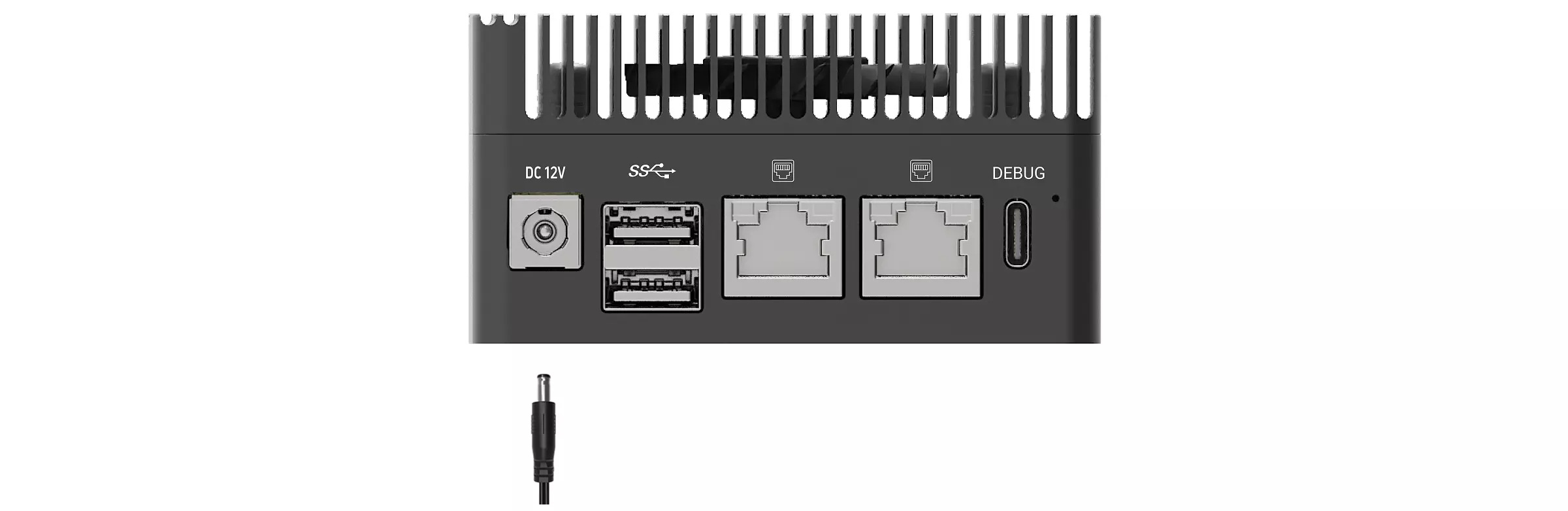

DC Power Input
The Fogwise® AIRbox Q900 is powered by a 12V DC power adapter.
Interface Specifications​
ParameterSpecification
Interface TypeDC Jack
Jack Size2.5mm inner diameter, 5.5mm outer diameter
PolarityCenter positive
Voltage12V
Current (Recommended)≥ 5.4A
CompatibilitySupports PD power adapter
User Guide​
Use the original or compatible 12V DC power adapter to power the mainboard.
Important Notes​
  • Using a non-compliant power supply may damage the device
  • Ensure sufficient power supply to avoid system instability due to insufficient powe
