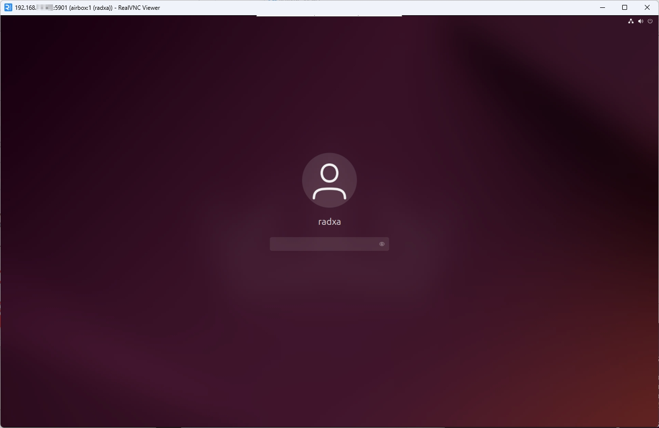

VNC Remote Login​
On another device, open the VNC Viewer software and connect to the board using its IP address and port number.
① Enter the board's IP address and port number
② Click Connect to address ··· to connect to the board
① Enter the VNC remote password you set
② Check the Remember password option to save the password for future logins
③ Click OK to connect
Upon successful login, you'll see the system's desktop environment.
