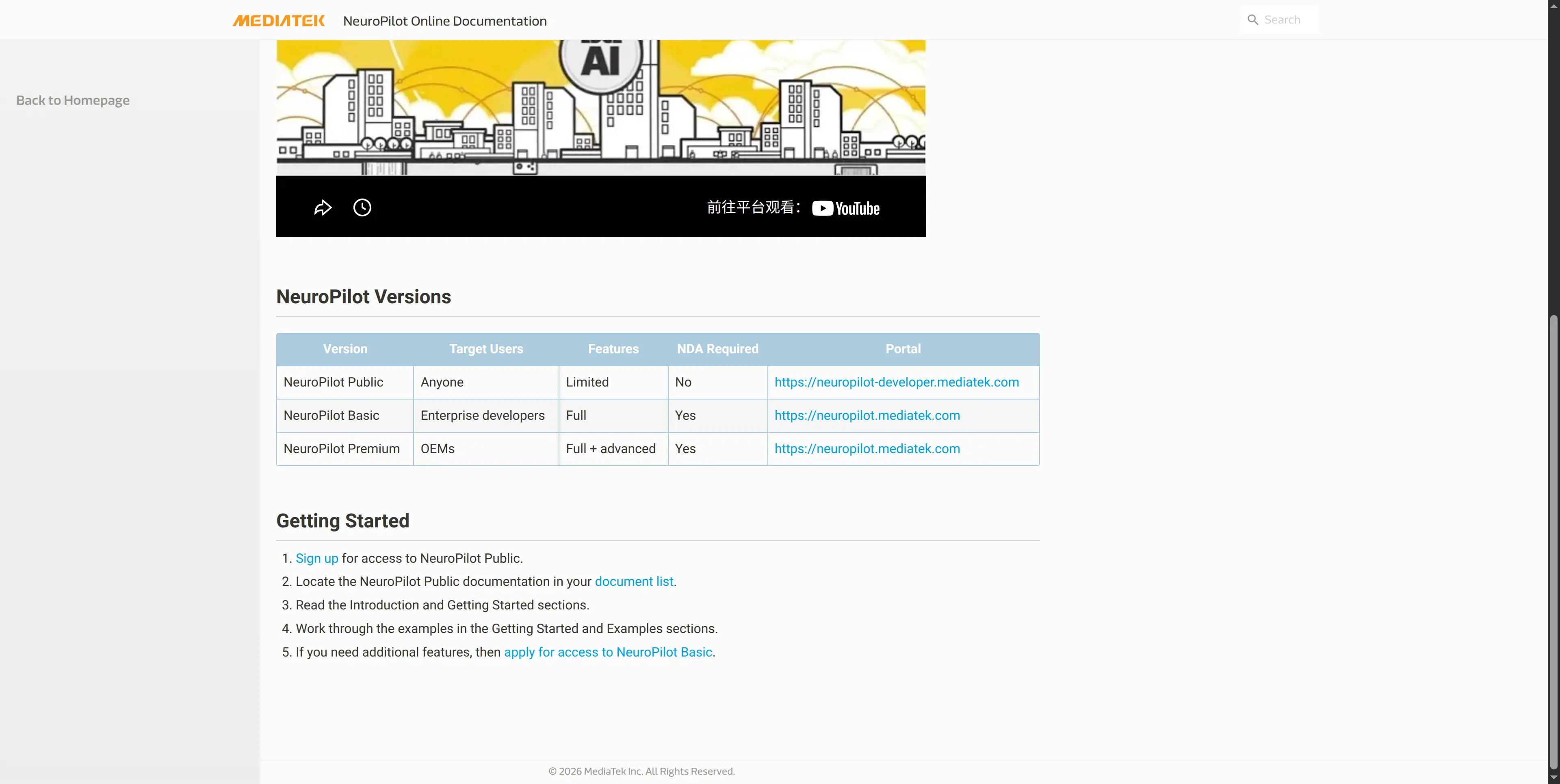

To convert models in various formats to the tflite format required by the device, you need a toolchain that includes the NeuroPilot Converter.

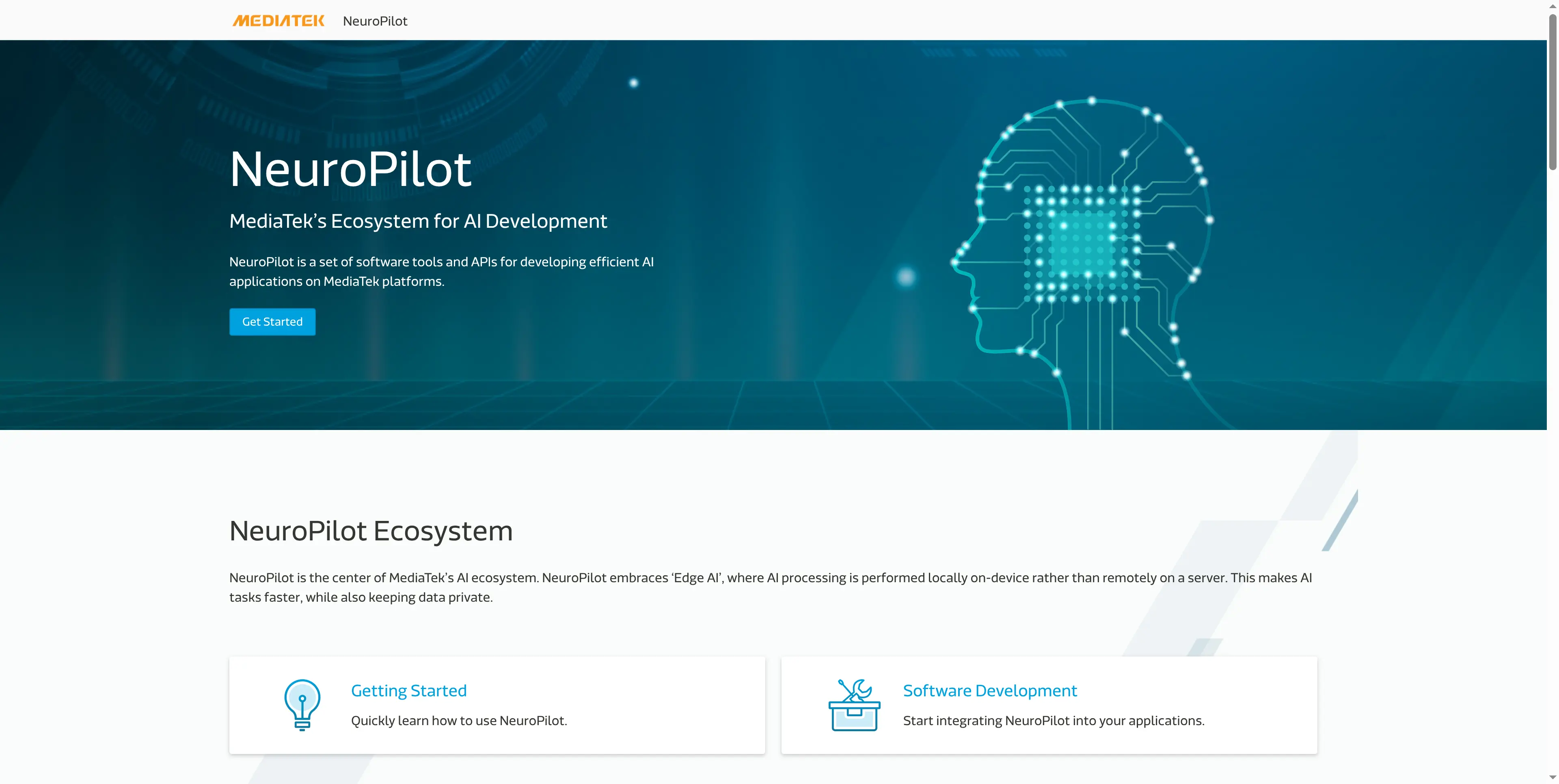

Go to the MediaTek NeuroPilot website and click Get Started
MediaTek NeuroPilot Website

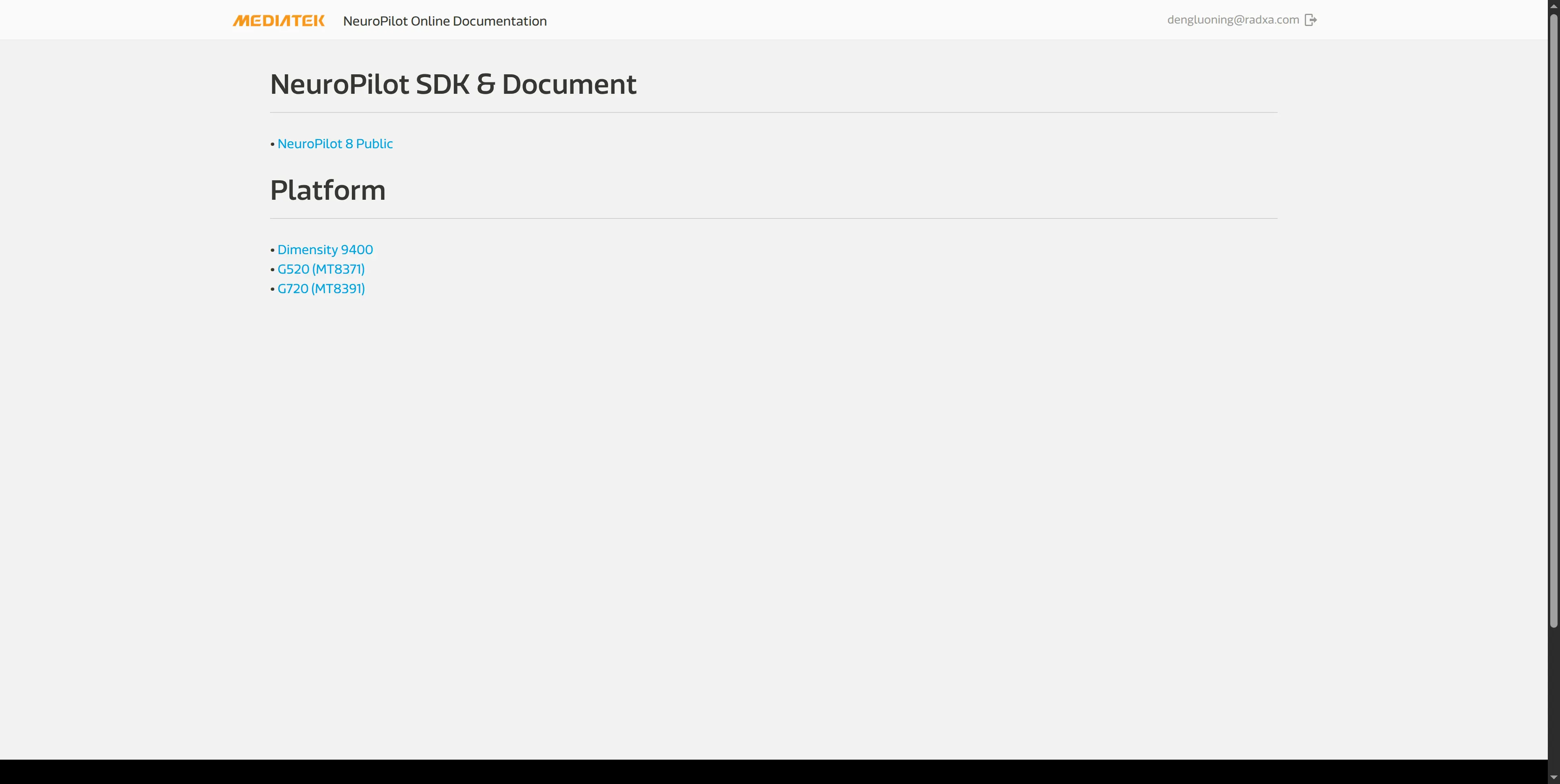

Register an account, then return to this page and click document list to see the NeuroPilot 8 Public documentation
NeuroPilot8 Public Toolchain
Go to the download page to get the SDK compressed package.
