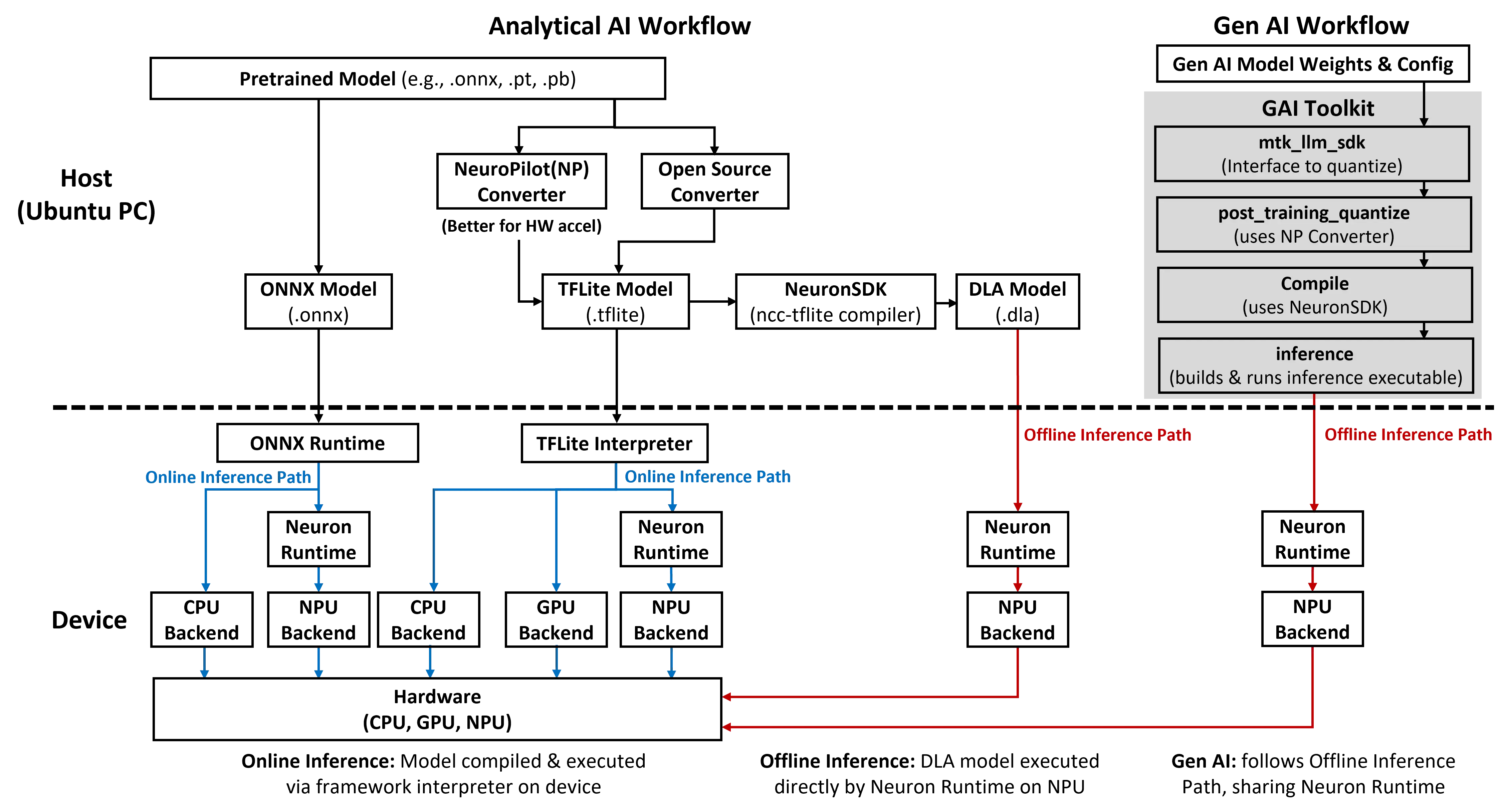

The Genio AI software stack supports both analytical AI and generative AI, using a host-device architecture. This means models are converted and quantized on the host, then the processed models are run on the device.
AI Software Stack Overview
Two Modes​
The inference modes running on the device are divided into online and offline modes:
ModeInference FrameworkModel Format
onlineGeneral AI frameworks (TFlite, ONNX)tflite, onnx
offlineNeuron Runtimedla
The core difference is whether a general AI framework's inference parsing tool needs to be configured on the device. Both modes require configuring the NPU's Neuron Runtime, because when the general AI framework's inference parsing tool calls the NPU, it also goes through Neuron Runtime.

Generative AI Deployment Process
  1. Quantize the model using the mtk_llm_sdk tool
  2. Convert to tflite format using the post_training_quantize tool
  3. Convert to dla format using NeuroPilot Converter
  4. Compile into an executable and push to the device for execution
  5. Run on the NPU via Neuron Runtime on the device
