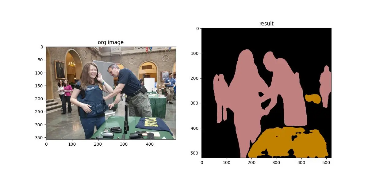

$ python3 inference_onnx.py --image_path test_data --onnx_path model/deeplabv3_resnet50.onnx
save output: onnx_ILSVRC2012_val_00004704.JPEG
Deploy on NPU
Run the inference script
O6 / O6N
python3 inference_npu.py --image_path test_data --model_path deeplab_v3.cix
Inference output
O6 / O6N
$ python3 inference_npu.py --image_path test_data --model_path deeplab_v3.cix
npu: noe_init_context success
npu: noe_load_graph success
Input tensor count is 1.
Output tensor count is 1.
npu: noe_create_job success
save output: npu_ILSVRC2012_val_00004704.JPEG
