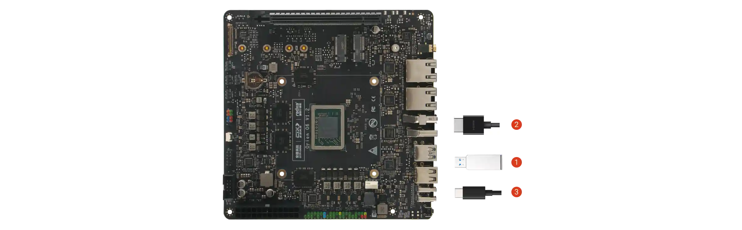

Booting the System​
After completing the system installation, insert the USB drive into the Radxa Orion O6's USB port, then power on the Radxa Orion O6 using the power adapter to boot the system.
① : Insert USB drive
② : Connect the monitor to the mainboard using HDMI/DP cable
③ : Power on the Radxa Orion O6 with the power adapter
When the system boots normally, the power indicator will light up green and the status indicator will flash blue.
