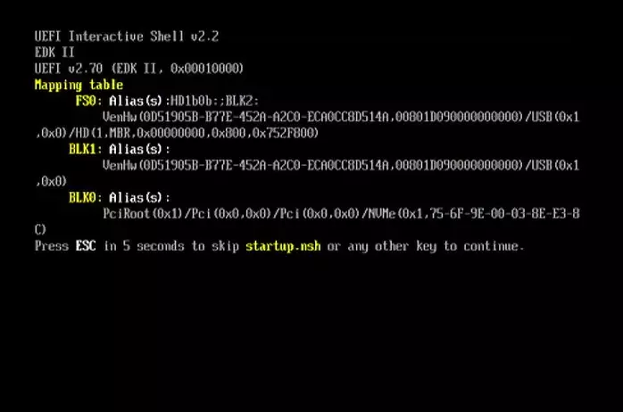

2. Run BIOS Flashing Script​
In the BIOS interface, navigate to Boot Manager -> EFI Shell. The system will automatically detect and run the startup.nsh script from the USB drive to complete the BIOS flashing process.
Entering Boot Manager
Selecting EFI Shell
Automatic Script Execution

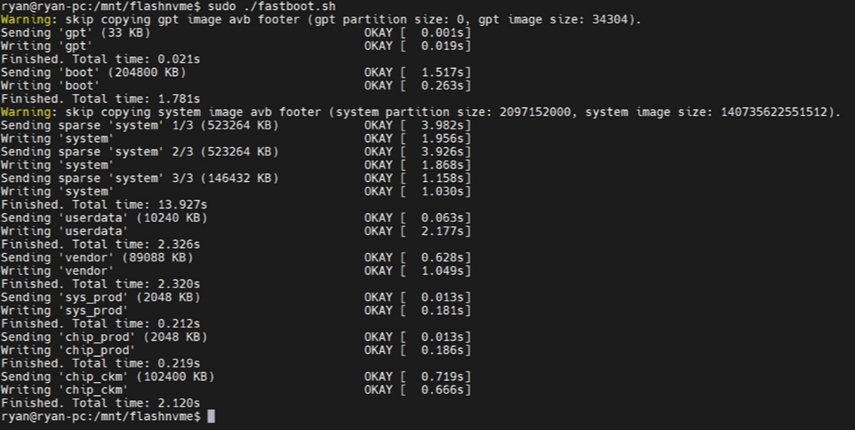

Open a terminal on your PC, navigate to the extracted OpenHarmony system image directory, and run the fastboot.sh script.
Ubuntu-PC$
sudo ./fastboot.sh
When the flashing is complete, you'll see the following:
The script will automatically complete the system flashing. After successful flashing, power cycle the board to boot into the OpenHarmony OS.
