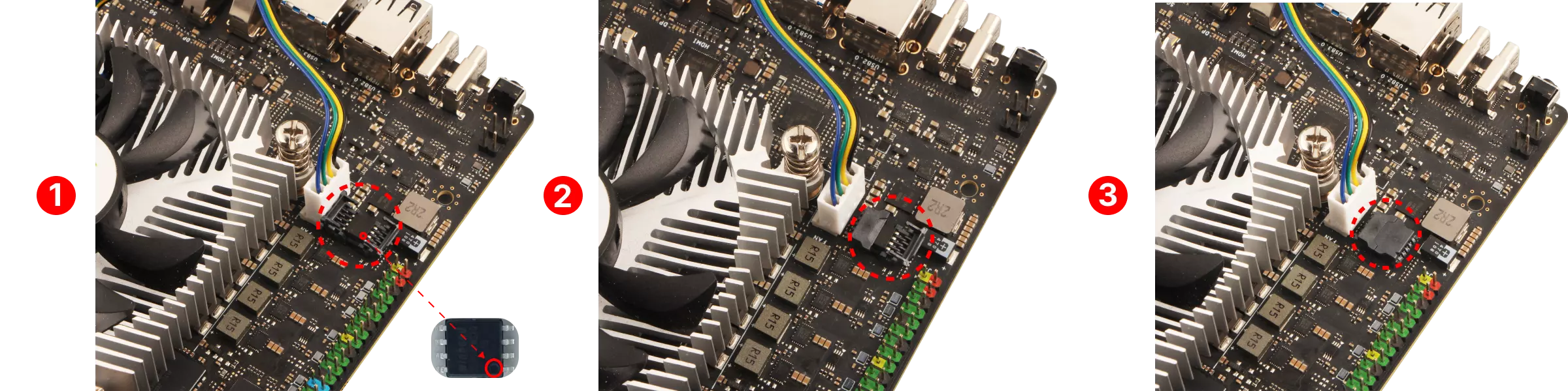

Remove and Install the SPI Flash Chip
Remove the SPI Flash Chip
Steps to remove the SPI Flash chip:
① : Locate the SPI Flash chip on the motherboard
② : Open the right latch cover of the SPI Flash
③ : Open the left latch cover of the SPI Flash
After completing the above steps, use tweezers to remove the SPI Flash chip from the motherboard

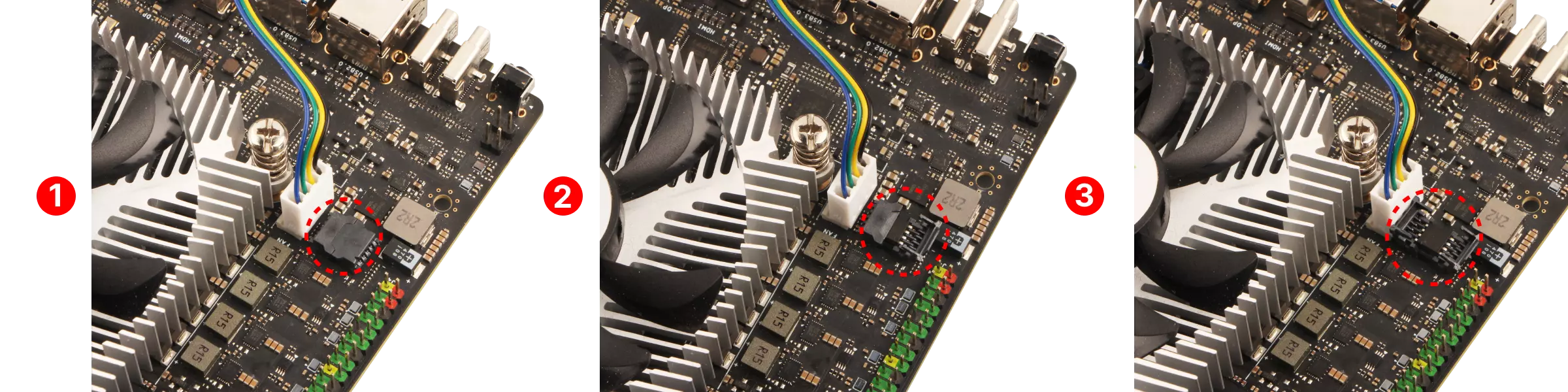

① : Install the SPI Flash chip onto the motherboard
② : Reattach the left latch cover of the SPI Flash
③ : Reattach the right latch cover of the SPI Flash
- The circle on the chip corresponds to pin 1, which is marked with a small red circle in the image.
- The socket for the SPI Flash has a triangular arrow that corresponds to pin 1 of the SPI Flash
You can confirm the installation orientation and position of the SPI Flash using the above two methods.
