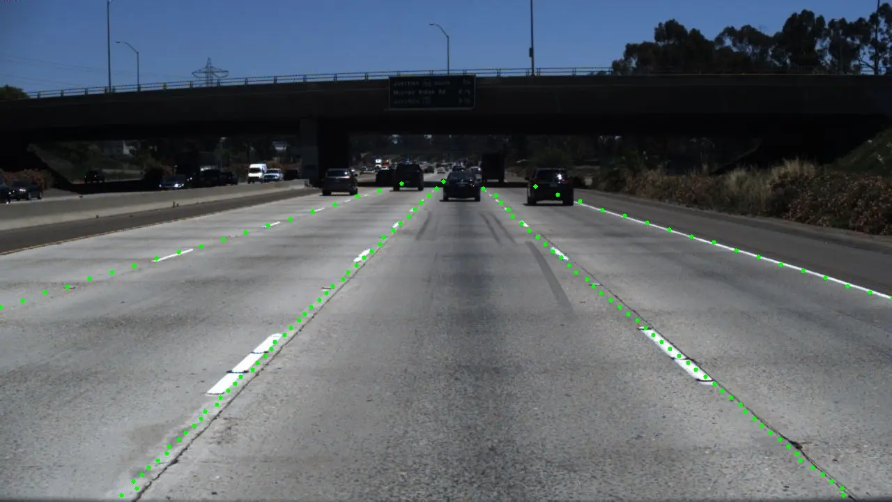

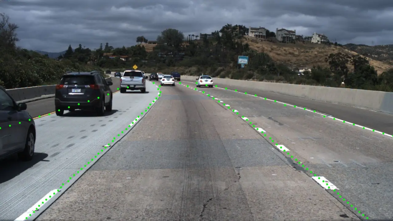

Run Inference Script​
Linux PC
python3 inference_onnx.py
Model Inference Results​
Deploy to NPU​

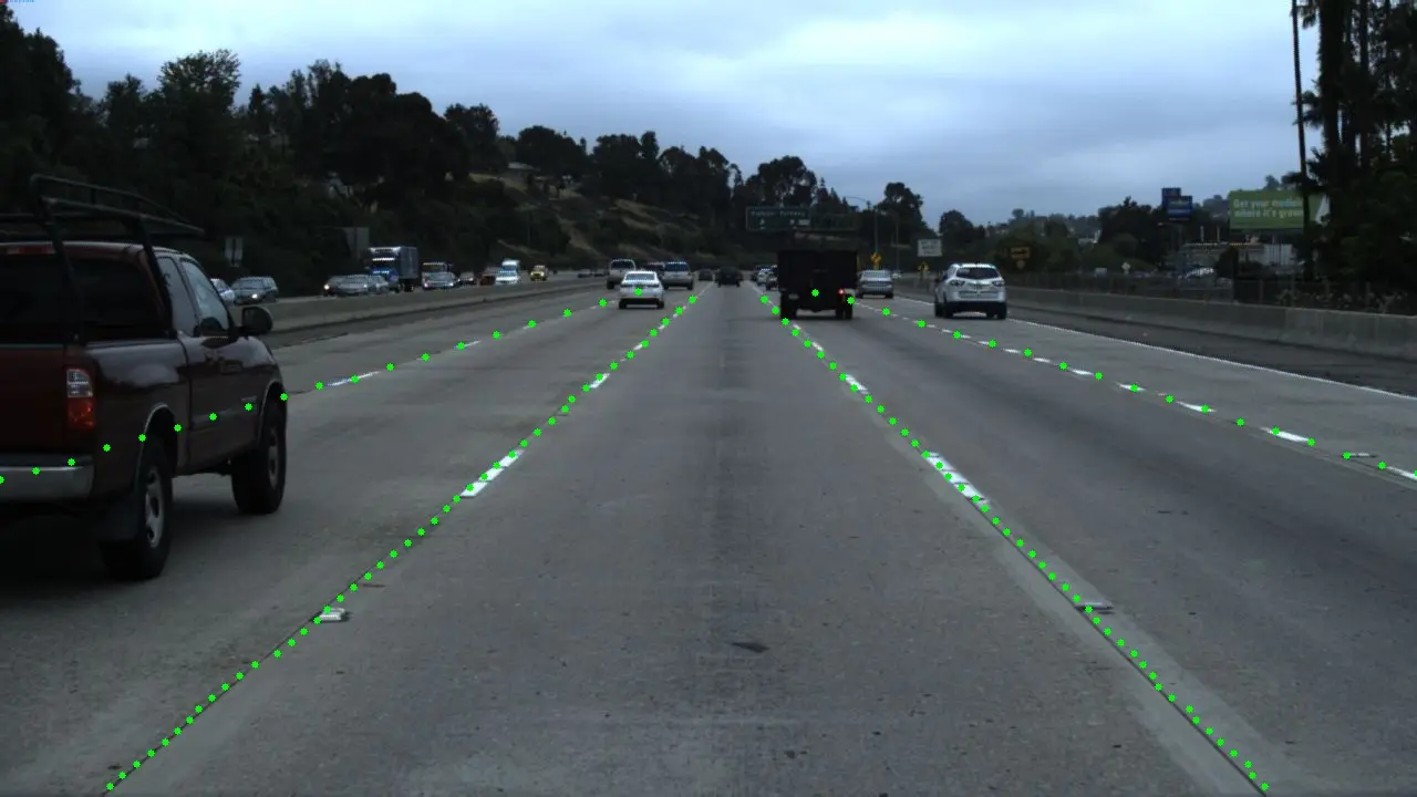

O6 / O6N
python3 inference_npu.py
O6 / O6N
$ python3 inference_npu.py
npu: noe_init_context success
npu: noe_load_graph success
Input tensor count is 1.
Output tensor count is 4.
npu: noe_create_job success
npu: noe_clean_job success
npu: noe_unload_graph success
