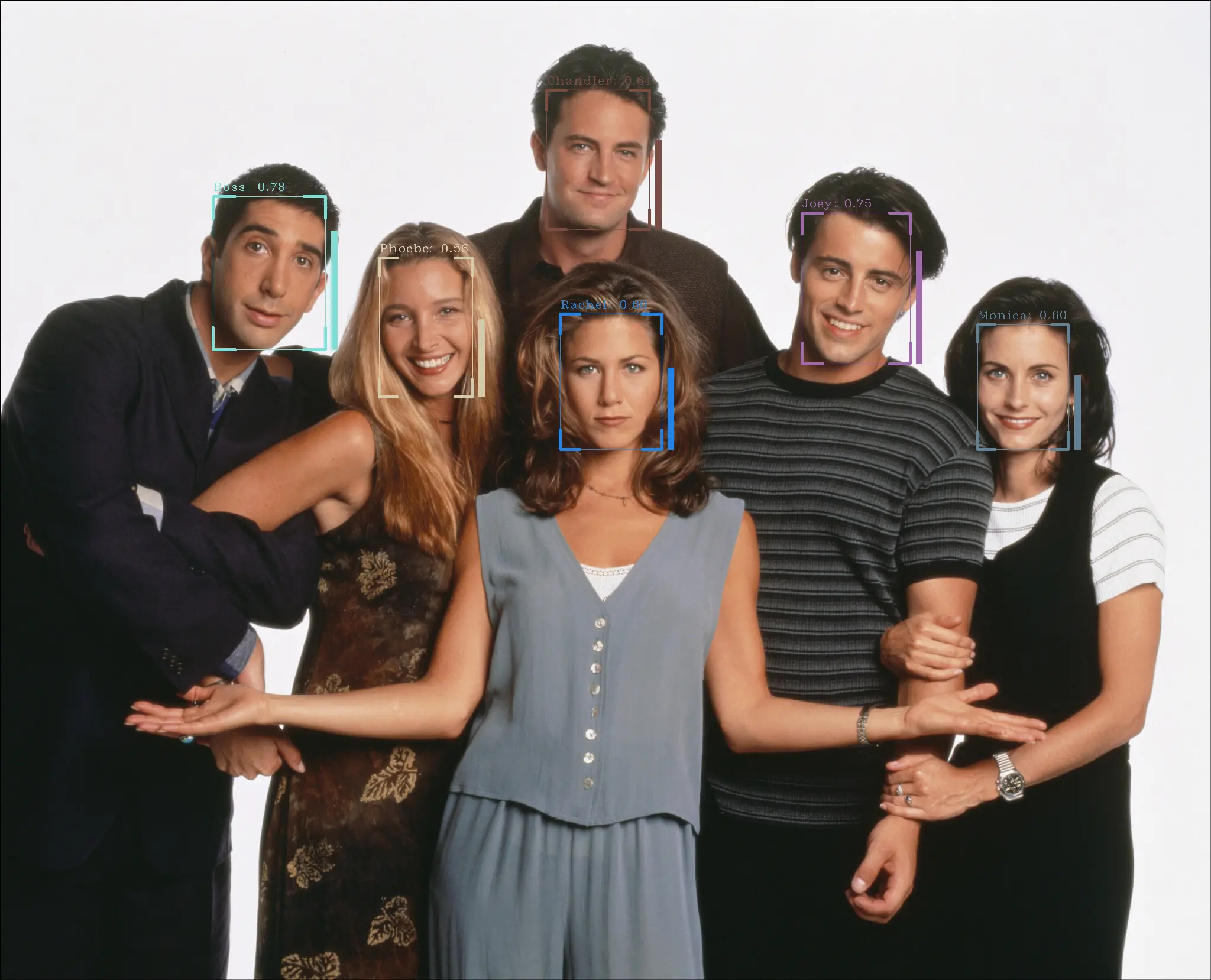

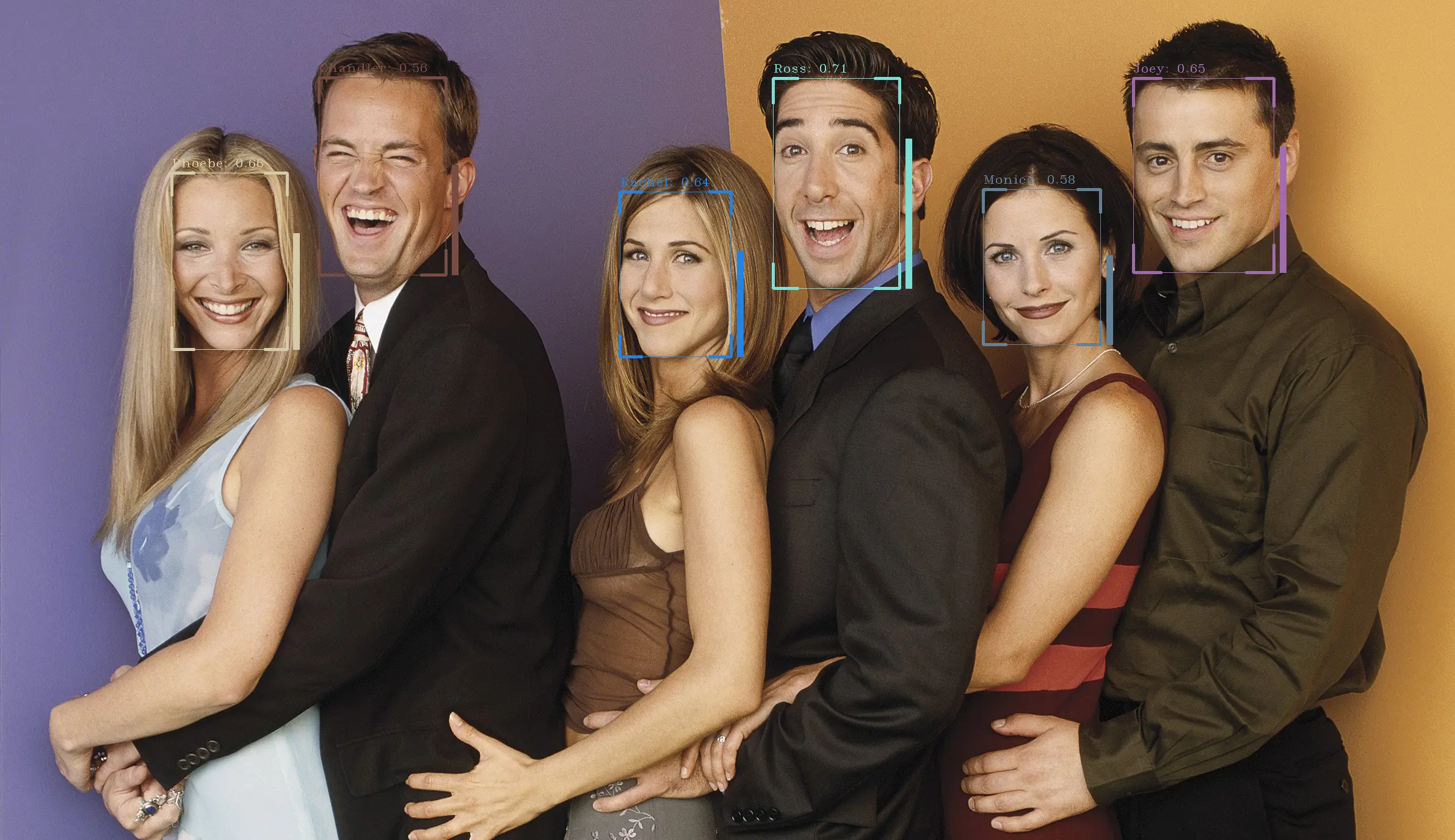

Test inference on the host
Run the inference script
Linux PC
python3 inference_onnx.py --det_onnx_path ./model/det_10g.onnx --rec_onnx_path ./model/w600k_r50.onnx --faces-dir ./datasets/faces --image_path test_data
Inference output
Deploy on NPU
O6 / O6N
python3 inference_npu.py --det_model_path ./scrfd.cix --rec_model_path ./arcface.cix --faces-dir ./datasets/faces --image_path test_data
Inference output
O6 / O6N
$ python3 inference_npu.py --det_model_path ./scrfd.cix --rec_model_path ./arcface.cix --faces-dir ./datasets/faces --image_path test_data
npu: noe_init_context success
npu: noe_load_graph success
Input tensor count is 1.
Output tensor count is 9.
npu: noe_create_job success
Output tensor count is 1.
./datasets/faces/Monica.png
./datasets/faces/Phoebe.png
./datasets/faces/Rachel.png
./datasets/faces/Chandler.png
./datasets/faces/Joey.png
./datasets/faces/Ross.png
npu: noe_clean_job success
npu: noe_unload_graph success
