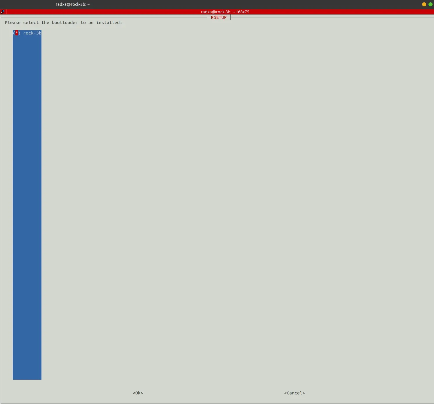

Select the bootloader option from the menu, then follow the prompts to update the SPI Flash:
rock-3b
