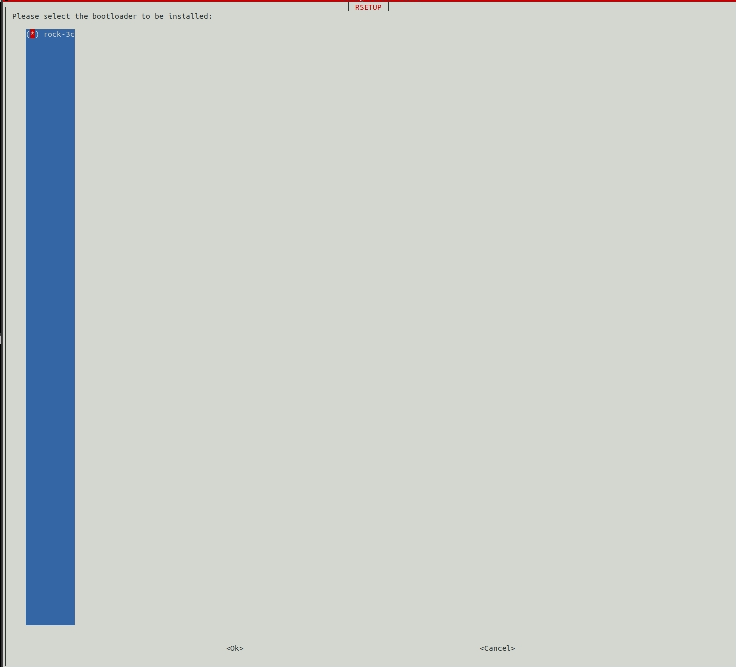

Select the bootloader option from the menu, then follow the prompts to update the SPI Flash:
rock-3c
Wait for the update to complete.
writing to mtd success
