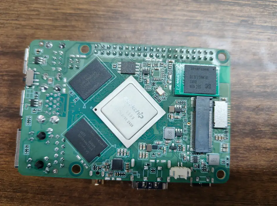

After successfully writing the image to the eMMC Module, insert it into the eMMC Module slot (as shown below), then power on the device. The system will start booting, and the desktop will be displayed on the HDMI monitor.
emmc slot
