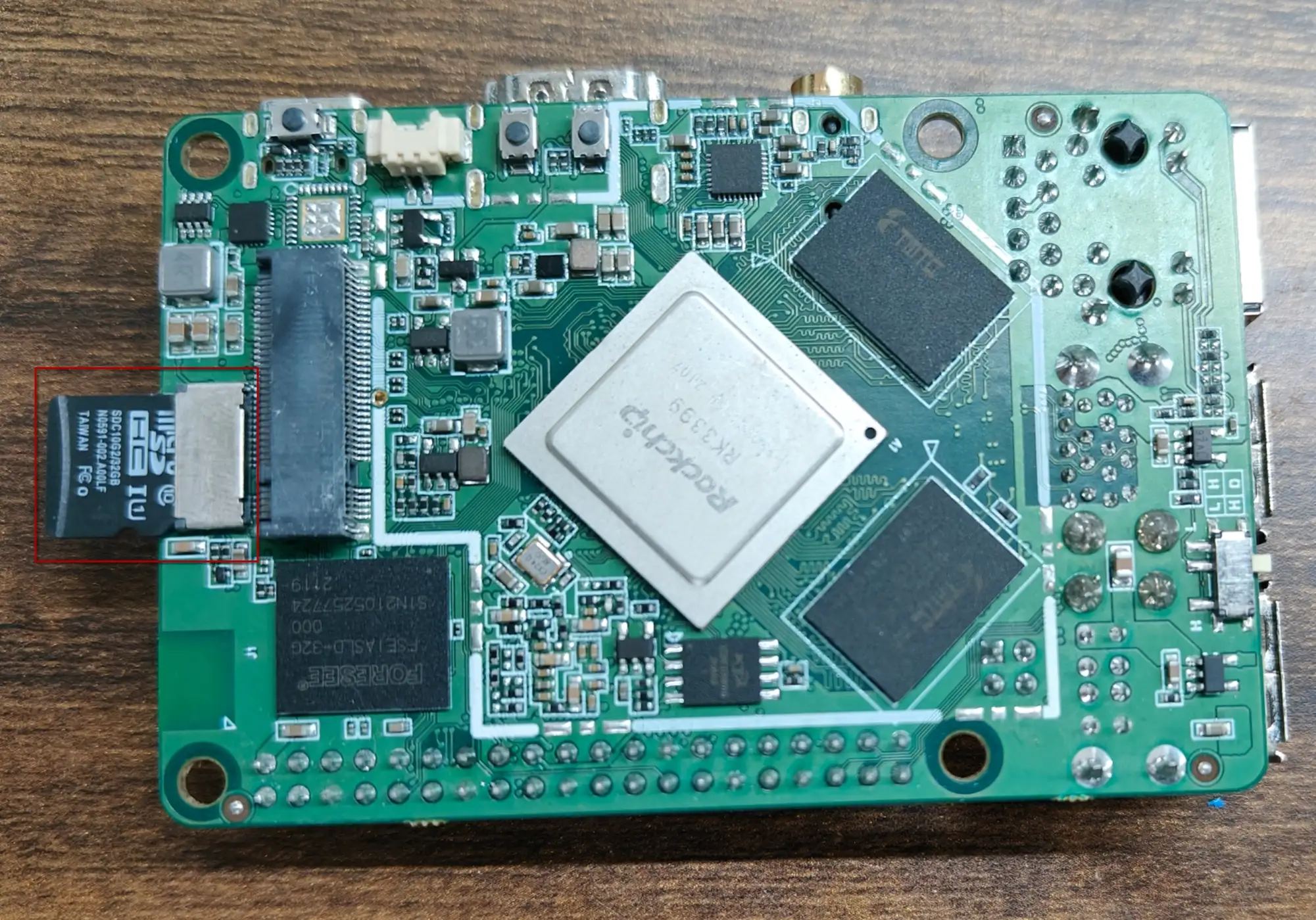

Boot the System​
After successfully writing the image to the microSD card, insert it into the microSD card slot (as shown below), then power on the device. The system will start booting, and the desktop will be displayed on the HDMI monitor.
sd slot
