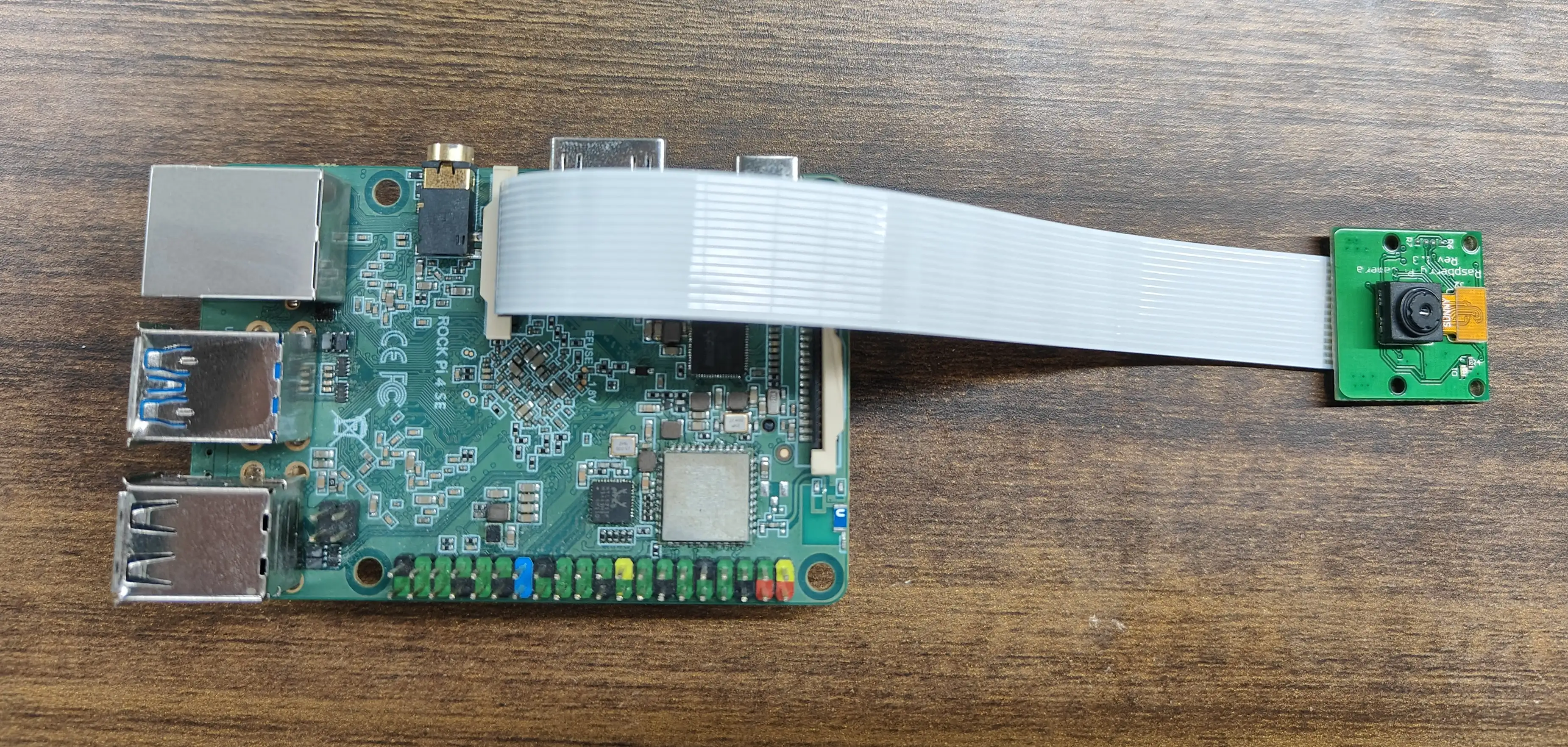

OKDO 5MP Camera​
  • Hardware Connection
Connect ROCK 4A/4A+/4B/4B+/4SE using the FPC cable as shown below:
  1. Lift the MIPI CSI interface latches on both the board and camera module to the unlocked position.
  2. Insert one end of the FPC cable into the board's MIPI CSI interface, then press down the latch to secure it after ensuring the cable is fully seated.
  3. Insert the other end of the cable into the camera module's MIPI CSI interface, then press down the latch to secure it after ensuring full insertion.
  4. Double-check that all latches on both the board and camera ends are securely locked, and that the cable lies flat without any twists.
Notes
  • Ensure the device is powered off before installation.
  • When connecting to the board's MIPI CSI interface, the gold fingers (metal contacts) of the cable should face the board's PCB.
  • When connecting to the camera module's MIPI CSI interface, the gold fingers should face the camera's PCB.
  • Avoid using excessive force during installation; ensure the cable is fully inserted before locking the latches to prevent damage to the cable or connectors.
camera connection
  • Enable Overlay
    1. Open the Kconsole terminal via the Application Launcher in the lower left corner and run the rsetup command:
     radxa@rock-4se:~$ rsetup
    1. Enable OKDO 5MP Camera Overlay by Device Tree Configuration .
    Please enable [] Enable OKDO 5MP Camera Overlay。
    Exit and reboot after enabling the successful display of [*] Enable OKDO 5MP Camera for the configuration to take effect.
    1. Reboot
  • Test
    1. Preview
    Open a terminal and enter the following command to open the camera preview:
    gst-launch-1.0 v4l2src device=/dev/video0 io-mode=4 ! videoconvert ! video/x-raw,format=NV12,width=1920,height=1080 ! xvimagesink;
    1. Take a picture
    Open a terminal and enter the following command to turn on the camera to take a picture:
    gst-launch-1.0 v4l2src device=/dev/video0 io-mode=4 ! videoconvert ! video/x-raw,format=NV12,width=1920,height=1080 ! jpegenc ! multifilesink location=file.name.jpg;
    1. Shooting videos
    Open a terminal and enter the following command to turn the camera on to capture video:
    gst-launch-1.0 v4l2src num-buffers=512 device=/dev/video0 io-mode=4 ! videoconvert ! video/x-raw, format=NV12, width=1920, height=1080, framerate=30/1 ! tee name=t ! queue ! mpph264enc ! queue ! h264parse ! mpegtsmux ! filesink location=/home/radxa/file.name.mp4

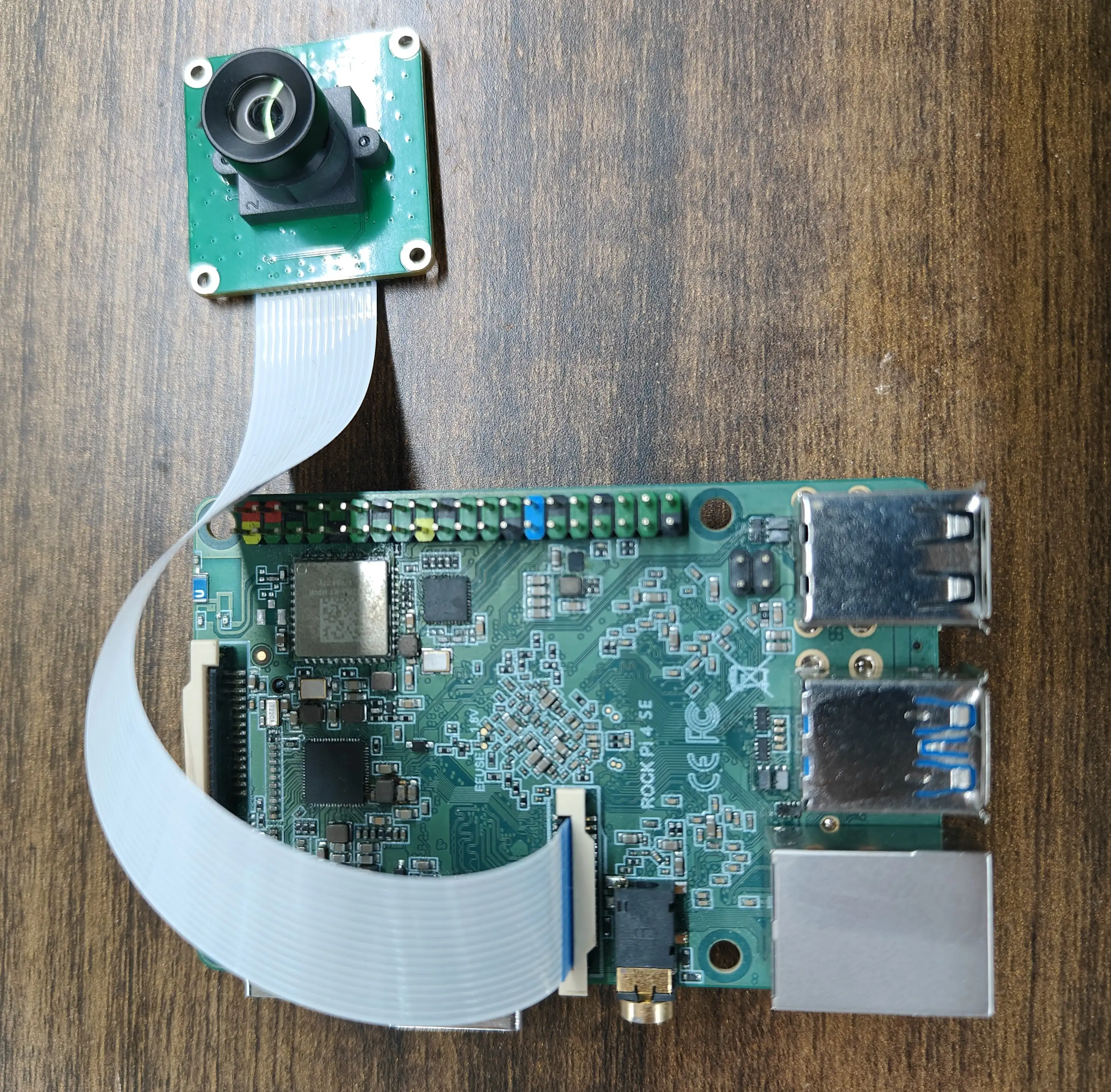

Radxa Camera 8M 219​
Notes
camera connection
  • Enable Overlay
    1. Enable Radxa Camera 8M 219 Overlay by Device Tree Configuration .
    Please enable [] Enable Radxa Camera 8M 219 Camera Overlay。
    Exit and reboot after enabling the successful display of [*] Enable Radxa Camera 8M 219 Camera for the configuration to take effect.
    1. Reboot
  • Test
    1. Preview
    1. Take a picture
    1. Shooting videos

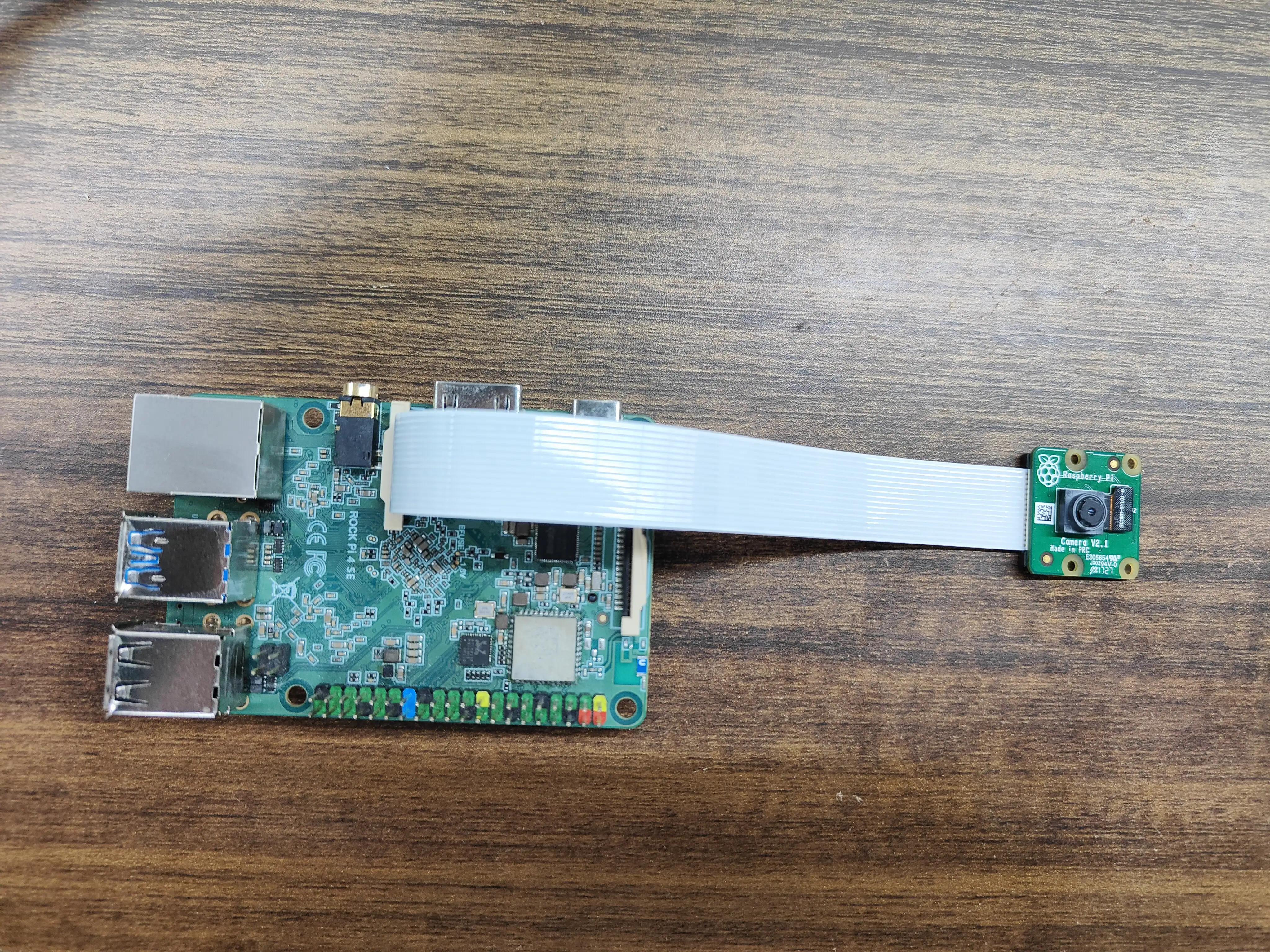

Raspberry Pi Camera V2​
Notes
camera connection
  • Enable Overlay
    1. Enable Raspberry Pi Camera V2 Overlay by Device Tree Configuration .
    Please enable [] Enable Raspberry Pi Camera V2 Overlay。
    Exit and reboot after enabling the successful display of [*] Enable Raspberry Pi Camera V2 for the configuration to take effect.
    1. Reboot
  • Test
    1. Preview
    1. Take a picture
    1. Shooting videos

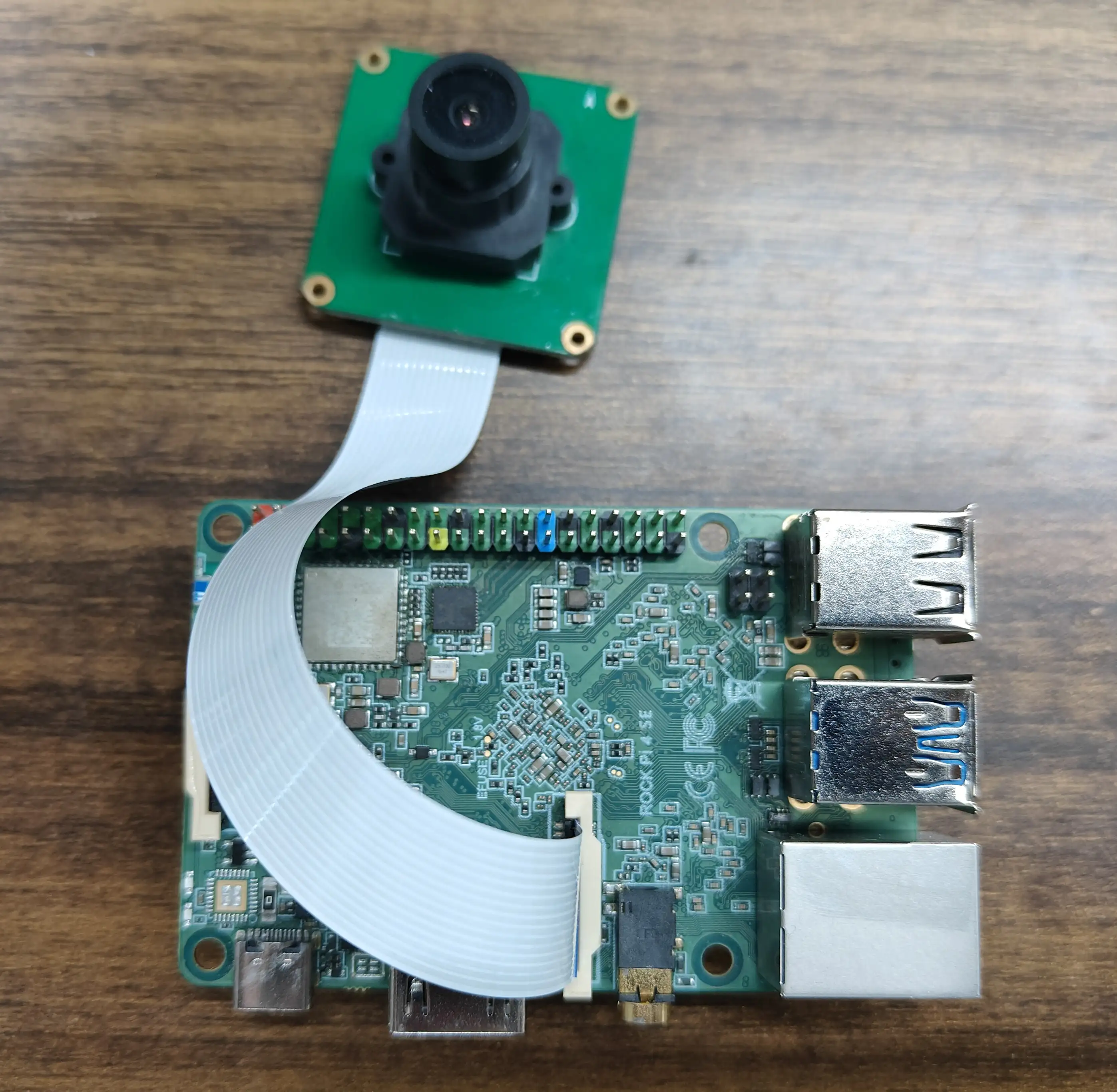

Raspberry Pi Camera v1.3​
Notes
camera connection
  • Enable Overlay
    1. Enable Raspberry Pi Camera v1.3 Overlay by Device Tree Configuration .
    Please enable [] Enable Raspberry Pi Camera v1.3 Overlay。
    Exit and reboot after enabling the successful display of [*] Enable Raspberry Pi Camera v1.3 for the configuration to take effect.
    1. Reboot
  • Test
    1. Preview
    1. Take a picture
    1. Shooting videos
