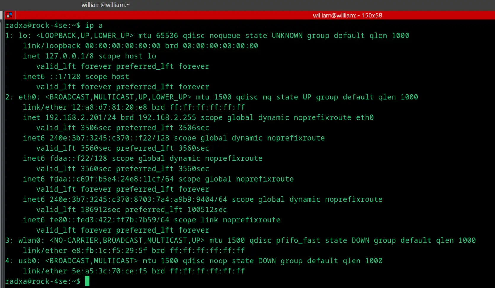

After the system boots up, open the terminal and run the following command to check if the Ethernet connection is working properly. If connected correctly, the ROCK 4A/4B/4A+/4B+/4SE will automatically obtain an IP address.
ip a
ip show
As shown in the image, the Ethernet has automatically obtained an IP address, indicating that the Ethernet connection is working properly.
