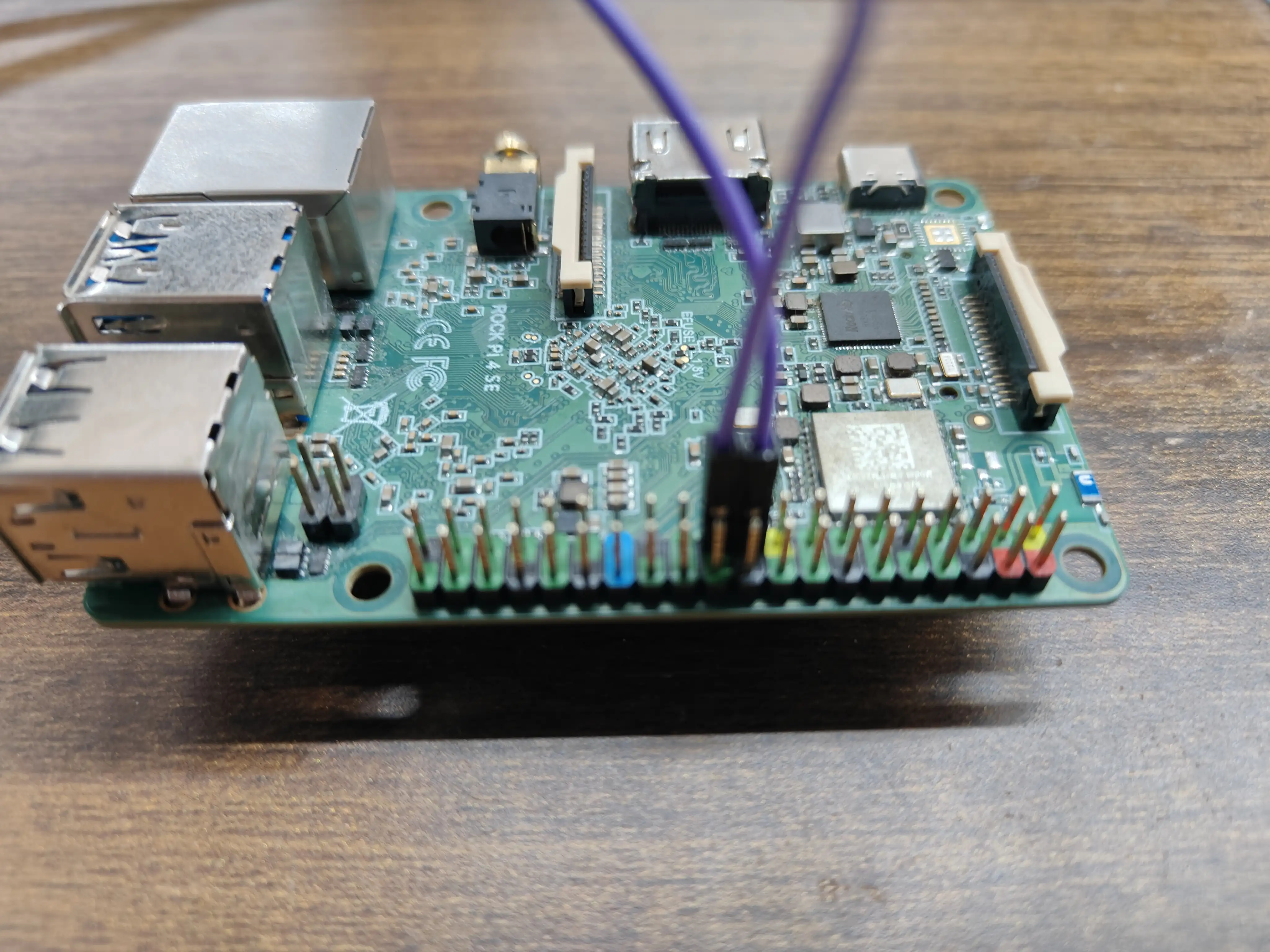

Connection​
Connecting PIN_11 of ROCK 4A/4B/4A+/4B+/4SE as shown
gpio connection
Test​
Input Tests​
Ground 11 or connect to 3.3V,
  radxa@rock-4se:~$ gpioget gpiochip4 18
This command outputs 0 if ground is connected and 1 if 3.3V is connected.
Output Test​
  radxa@rock-4se:~$ sudo gpioset -m signal $(sudo gpiofind PIN_11)=0 # Output low, Led off
  radxa@rock-4se:~$ sudo gpioset -m signal $(sudo gpiofind PIN_11)=1 # Output high, Led on

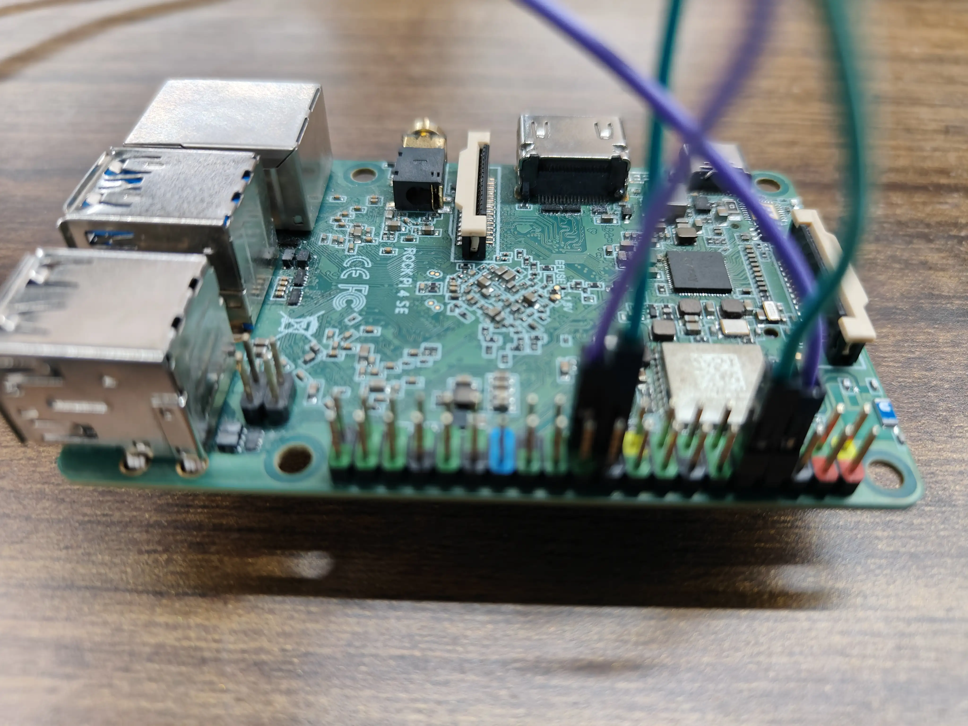

Connection​
Connect ROCK 4A/4B/4A+/4B+/4SE and OLED as follows
ROCK 4A/4B/4A+/4B+/4SE<-->OLED
PIN_28<-->SCL
PIN_27<-->SDA
PIN_1<-->VCC
PIN_9<-->GND
i2c connection

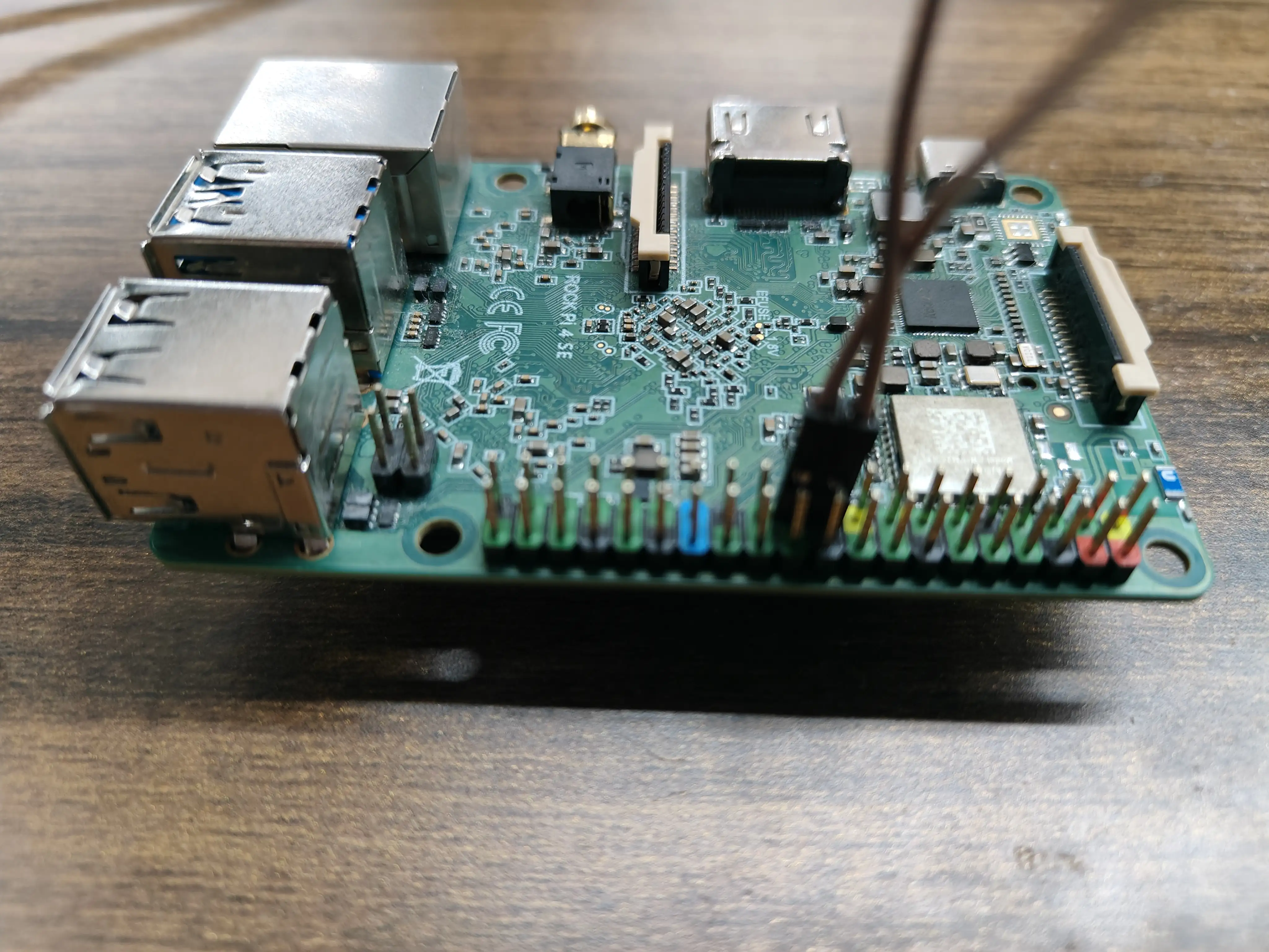

Connection​
As shown in the picture,connect ROCK 4A/4B/4A+/4B+/4SE's 15
pwm connection

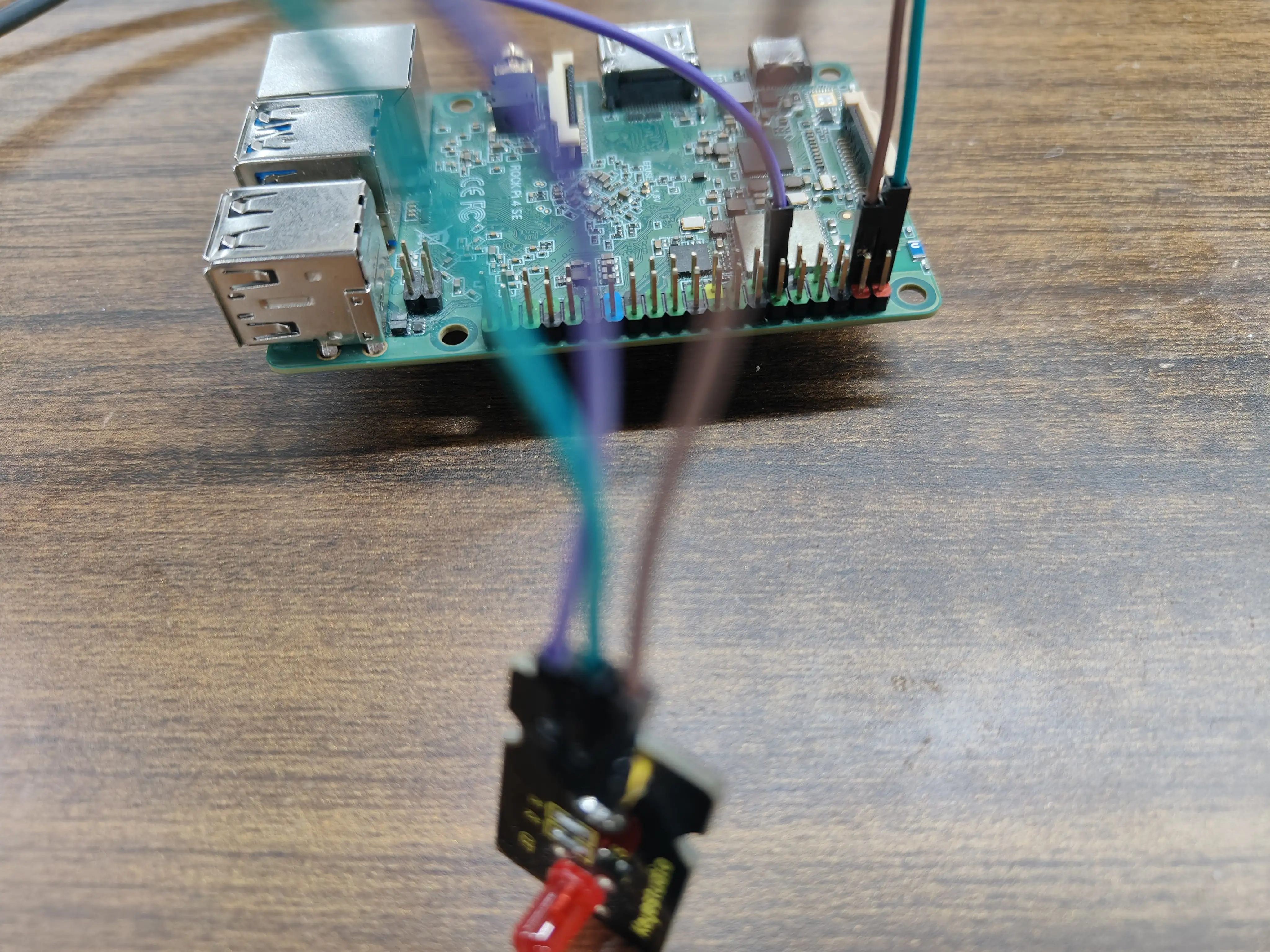

Connection​
Short 19 and 21 as shown
spi connection

Loopback test​
Enable Overlay​
Please refer to Device Tree Configuration to enable UART Related Overlay, eg: "Enable UART4".
Connection​
As shown in the figure, short the ROCK 4A/4B/4A+/4B+/4SE UART4's PIN_19 and PIN_21
uart connection
Test​
  • Open a terminal and enter the following command in the terminal to set the serial port parameters
  radxa@rock-4se:~$ sudo stty -F /dev/ttyS4 speed 115200 cs8 -parenb -cstopb  -echo
  • In the terminal, enter the following command to send data cyclically
  radxa@rock-4se:~$ while true ;do echo "sss" > /dev/ttyS4; sleep 1; done;
  • Create a new terminal and enter the following command to receive data
  radxa@rock-4se:~$ sudo cat  /dev/ttyS4

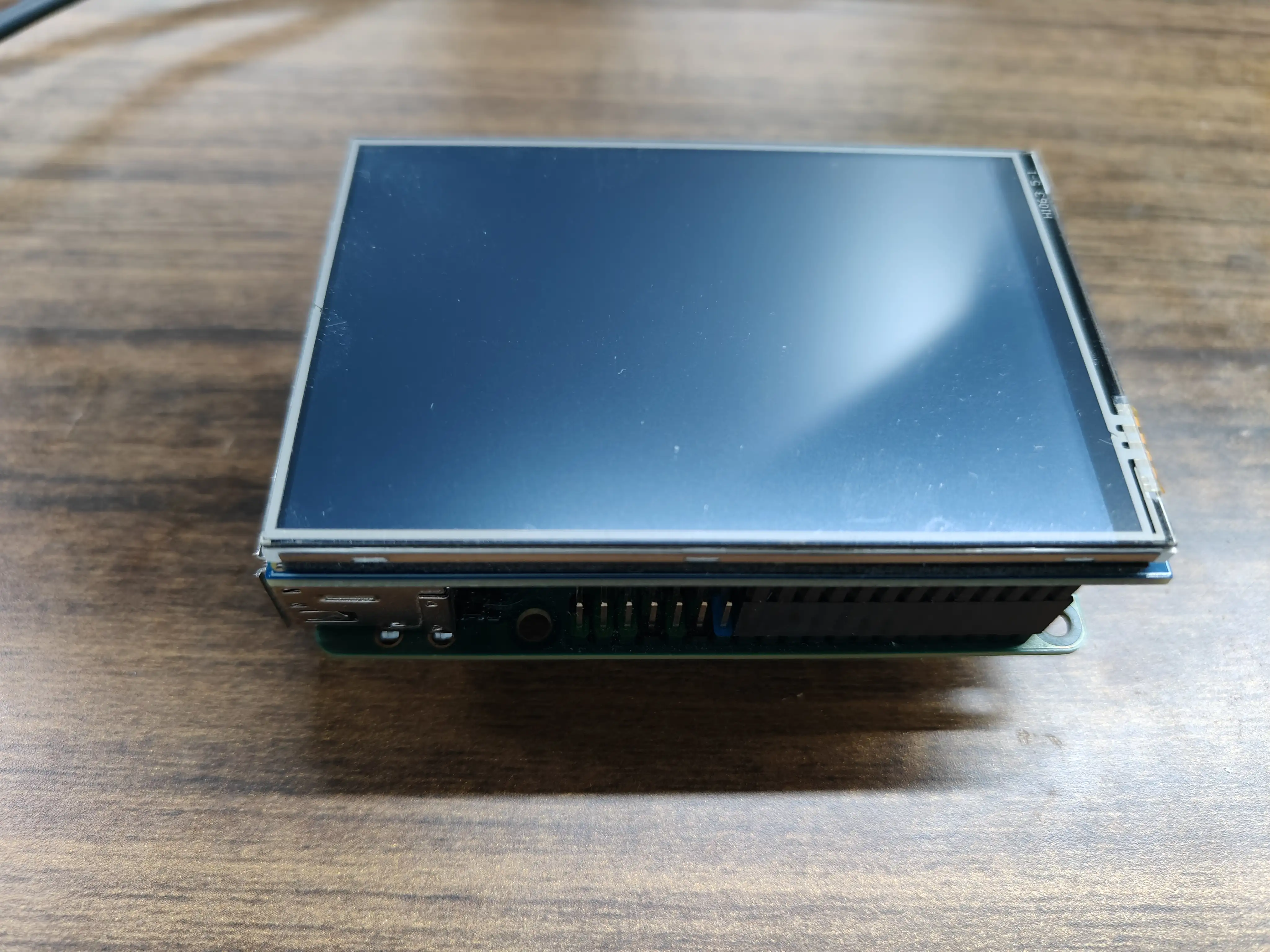

Waveshare 3.5 inch SPI TFT LCD Display​
  • Connecting this display
Connect the screen to the motherboard as follows:
waveshare spi tft display
  • Use rsetup to enable the corresponding overlay
  • After entering rsetup, enter the device tree management interface
Please enable [] Enable Waveshare 3.5inch RPi LCD (B) on SPI1 (No Touch Support) Overlay。
Exit and reboot after enabling the successful display of [*] Enable Waveshare 3.5inch RPi LCD (B) on SPI1 (No Touch Support) for the configuration to take effect.
  • Enable Waveshare 3.5 inch Display overlay
  • Configuration Display
  • Backup /usr/share/X11/xorg.conf.d/20-modesetting.conf
sudo mv /usr/share/X11/xorg.conf.d/20-modesetting.conf /usr/share/X11/xorg.conf.d/20-modesetting.conf.bak
  • Add a configuration file 20-modesetting.conf under /etc/X11/xorg.conf.d with the following contents:
Section "Device"     Identifier "Rockchip Graphics"     Driver "fbdev"     Option "fbdev" "/dev/fb0"     Option "DRI" "2" EndSection
Add a configuration file 99-touchscreen-calibration.conf under /etc/X11/xorg.conf.d with the following contents:
Section "InputClass"     Identifier "calibration"     MatchProduct "ADS7846 Touchscreen"     Option "TransformationMatrix" "-1 0 1 0 1 0 0 0 1" EndSection
  • Reboot
sudo reboot
After rebooting the system, the screen should now display normally.
