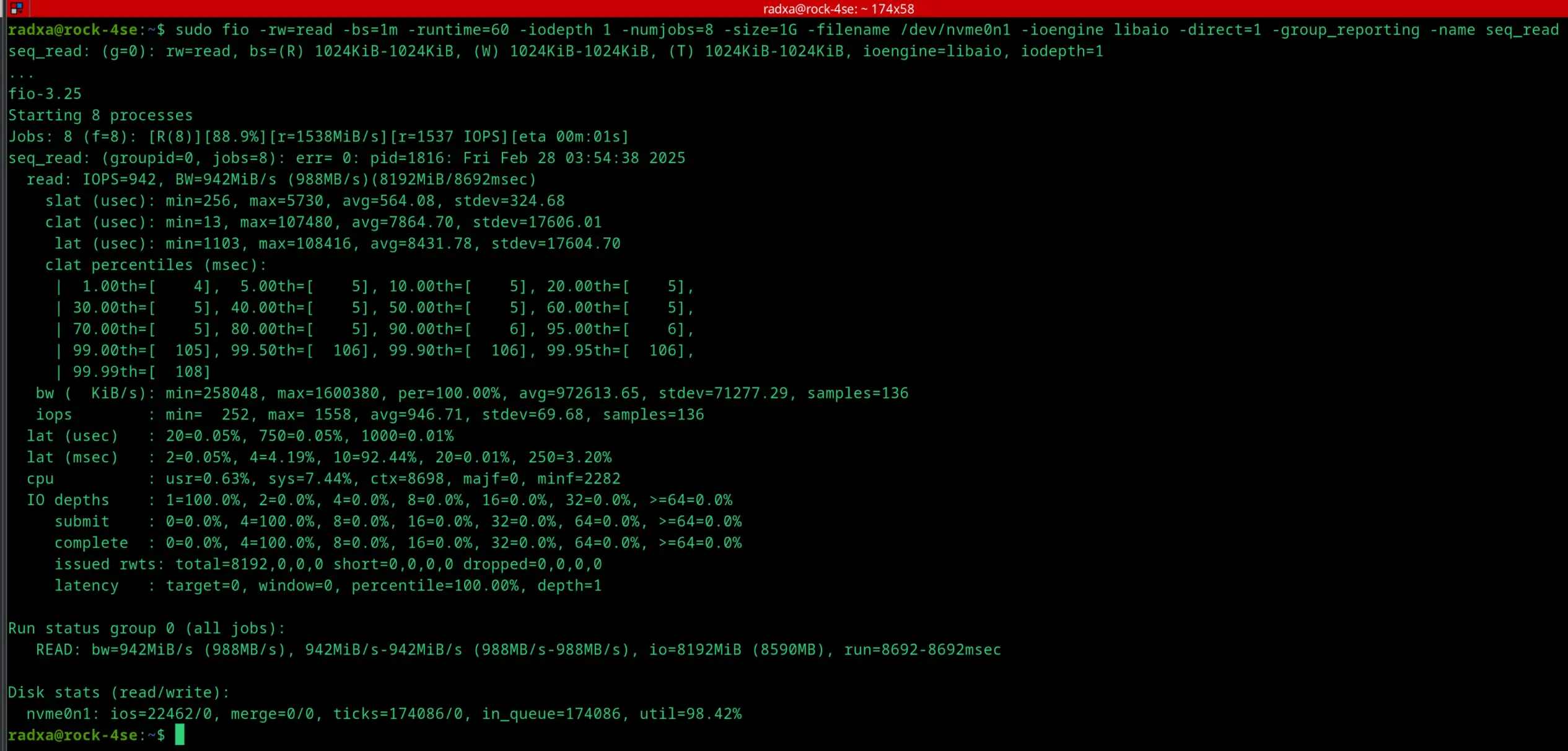

  2. Reading test
    radxa@rock-4se:~$ sudo fio -rw=read -bs=1m -runtime=60 -iodepth 1 -numjobs=8 -size=1G -filename /dev/nvme0n1 -ioengine libaio -direct=1 -group_reporting -name seq_read
read test

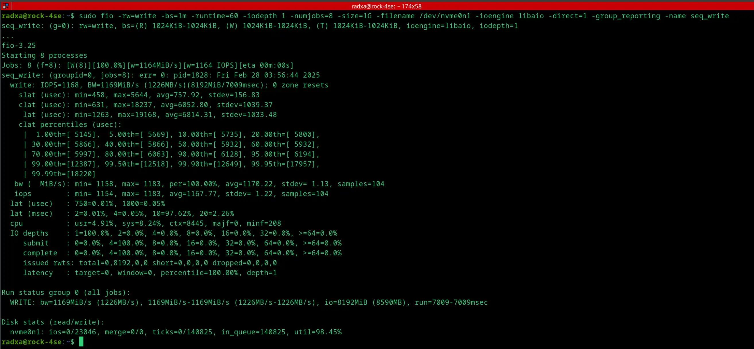

  1. Writing test
    radxa@rock-4se:~$ sudo fio -rw=write -bs=1m -runtime=60 -iodepth 1 -numjobs=8 -size=1G -filename /dev/nvme0n1 -ioengine libaio -direct=1 -group_reporting -name seq_write
write test
