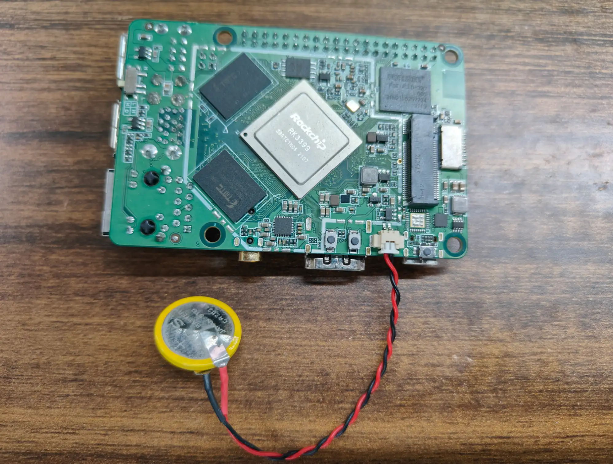

  • Install the Battery
    As shown in the image, install the RTC (Real-Time Clock) battery into the RTC interface on the ROCK 4.
    rtc connection
