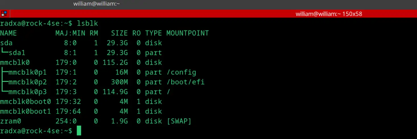

    1. Identify the USB memory device
    Confirm USB memory device via lsblk
    pwm fan result img
    As shown above, the USB storage device inserted into ROCK 4SE is /dev/sda.
