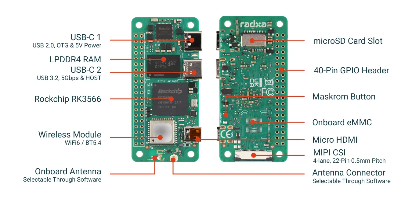

ZERO 3W Overview
How to enter Maskrom mode on Radxa ZERO 3W
  1. Remove the microSD card and power cable
  2. Press and hold the Maskrom button on the back of the
  3. Connect the USB of PC host via USB-A to USB-C cable, if the green light of the power supply is always on, it will enter the Maskrom mode successfully
The OTG interface on the Radxa ZERO 3 is TYPE-C, which allows communication between the host computer and the motherboard entering the Maskrom via a USB-C to USB-A cable.
