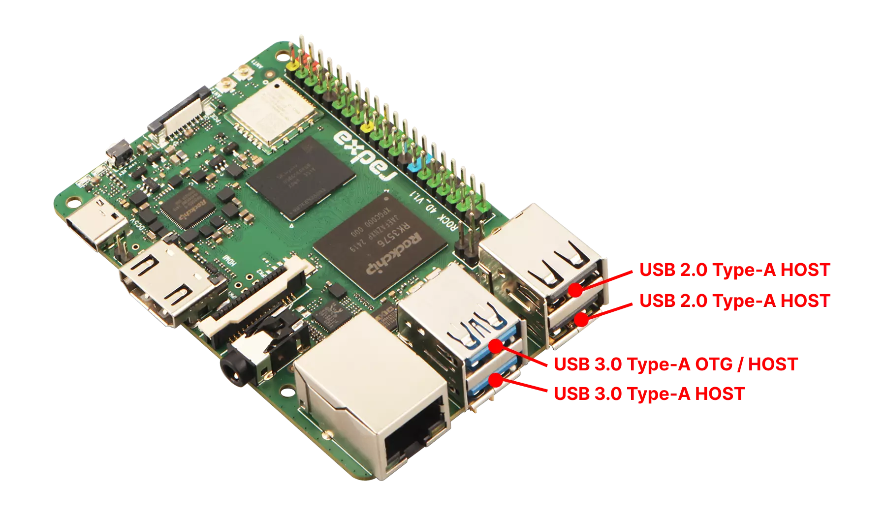

USB Type-A Ports
The Radxa ROCK 4D features 4 onboard USB Type-A ports, including 2 USB 3.0 ports and 2 USB 2.0 ports.
  • USB 3.0 Type-A
    • Theoretical maximum transfer rate: 5Gbps
    • Ports are typically colored blue internally
    • The top USB 3.0 Type-A port supports both OTG and HOST modes
    • The bottom USB 3.0 Type-A port supports HOST mode only
  • USB 2.0 Type-A
    • Theoretical maximum transfer rate: 480Mbps
    • Ports are typically colored black internally
