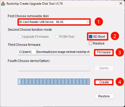

You need to use the official Rockchip SDDiskTool to flash the system image to the MicroSD card.
warning
Installing the system will format the MicroSD card. Please backup important data in advance!
SDDiskTool​
SDDiskTool currently only supports Windows systems. Please use it on a Windows system.
After downloading SDDiskTool, unzip it and double-click SDDiskTool.exe to use it.
Hardware Connection​
Insert the MicroSD card into the MicroSD card reader, then insert the MicroSD card reader into the computer.
Flash System Image​
Follow the steps below to use SDDiskTool to flash the system image to the MicroSD card:
① Select the MicroSD card device
② Select the SD Boot option
③ Select the system image file built by the Yocto Project
④ Click the create button to start flashing the system image
