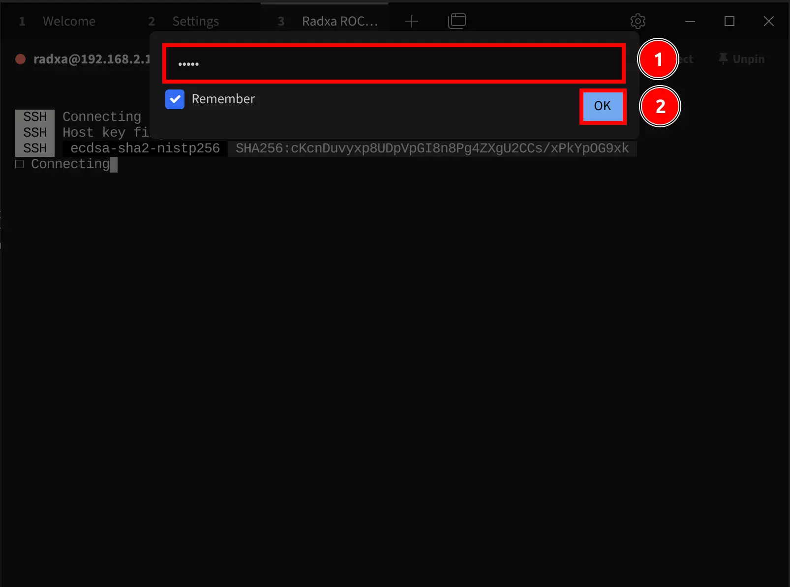

SSH Remote Login​

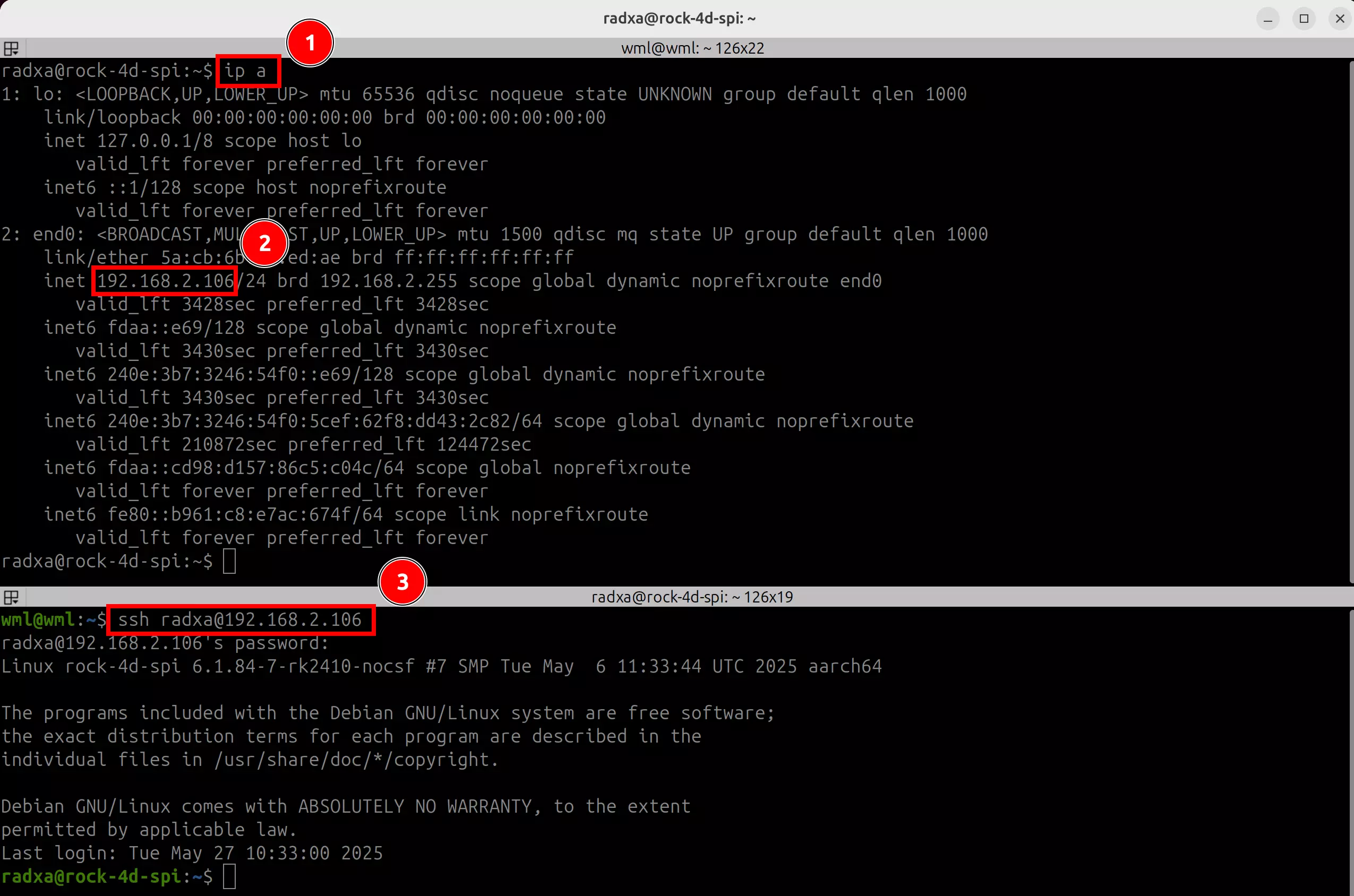

On another device, open a terminal and use the following command to connect. You can find the ROCK 4D's IP address using the ip a command.
Host-PC$
ssh <user-name>@<ip-address>
# Example
ssh [email protected]
Where <user-name> is your ROCK 4D username and <ip-address> is the board's IP address.
① : Query the ROCK 4D's IP address (in this case, obtained via serial connection).
② : The actual IP address of the ROCK 4D.
③ : Remote login to ROCK 4D via SSH.
