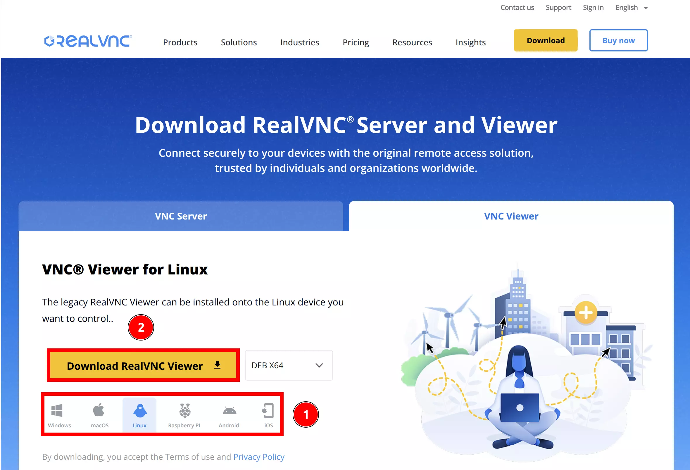

Download VNC Viewer​
We need to install VNC Viewer software on the remote device (PC) to control the motherboard.
Go to the RealVNC website to download the VNC Viewer installation package for your system platform.

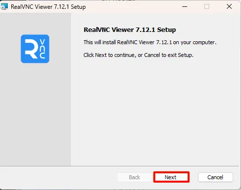

  • Start installation
Click Next to start the installation program.

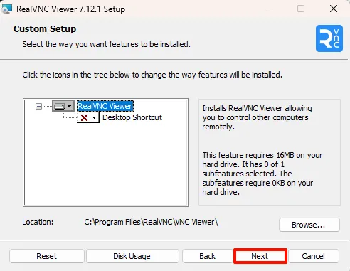

  • Installation path
It's recommended to use the default installation path. Click Next to proceed.

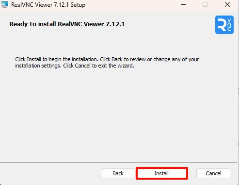

Click Install to begin the installation.

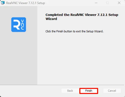

  • Complete installation
Click Finish to complete the installation.

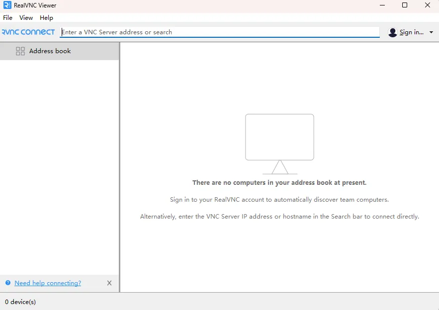

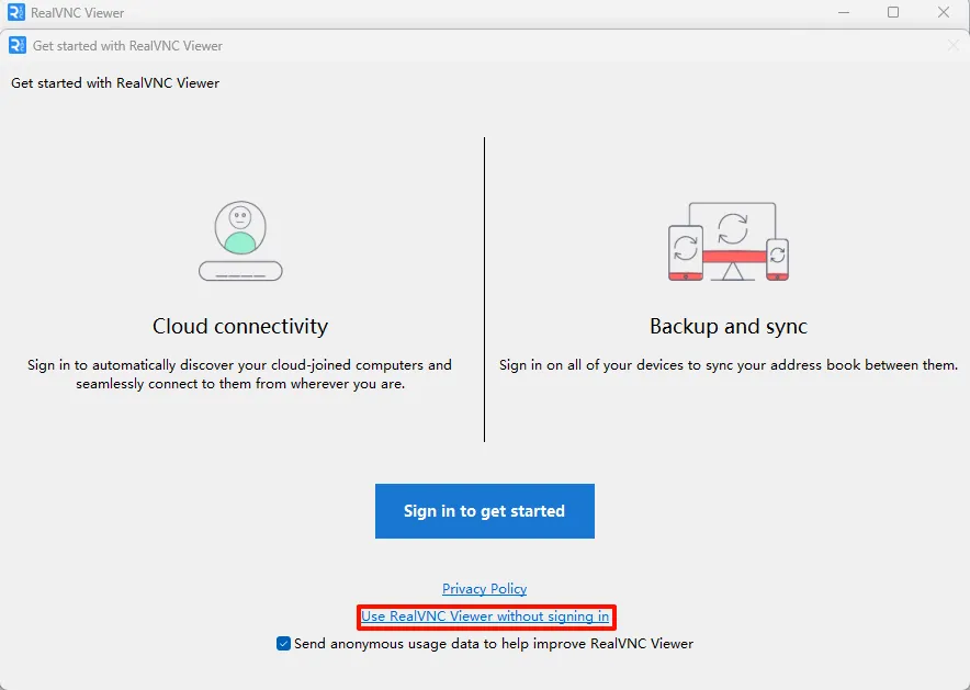

Run VNC Viewer​
After installation, open the VNC Viewer software. Users can choose to use VNC Viewer without logging in.
VNC Viewer Interface

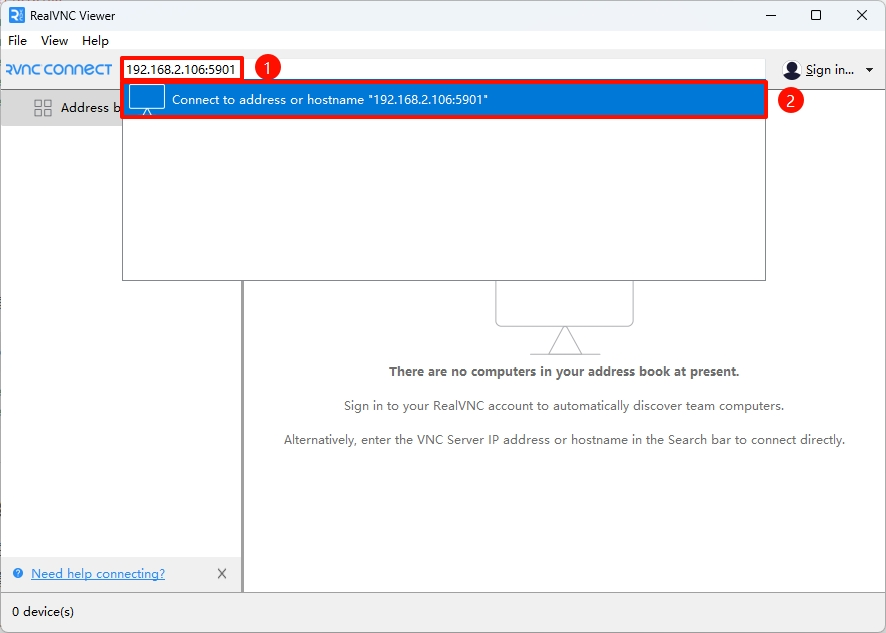

Open the VNC Viewer software on another device and connect to the ROCK 4D using its IP address and port number.
① Enter the ROCK 4D's IP address and port number
② Click Connect to address ··· to connect to ROCK 4D

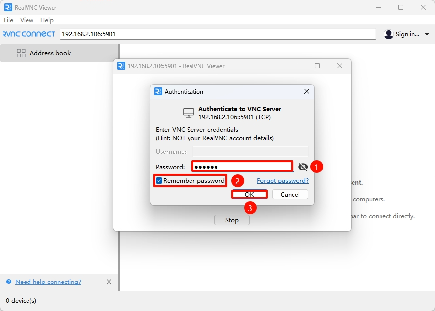

① Enter the VNC remote password
② Check the Remember password option to save the password for future logins
③ Click OK to connect
Successful VNC Remote Login
