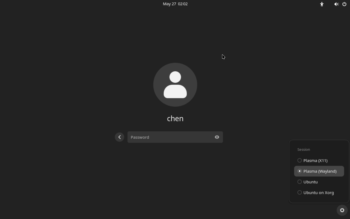

  1. After restart, you can select the Wayland session in the lower right corner during login:
