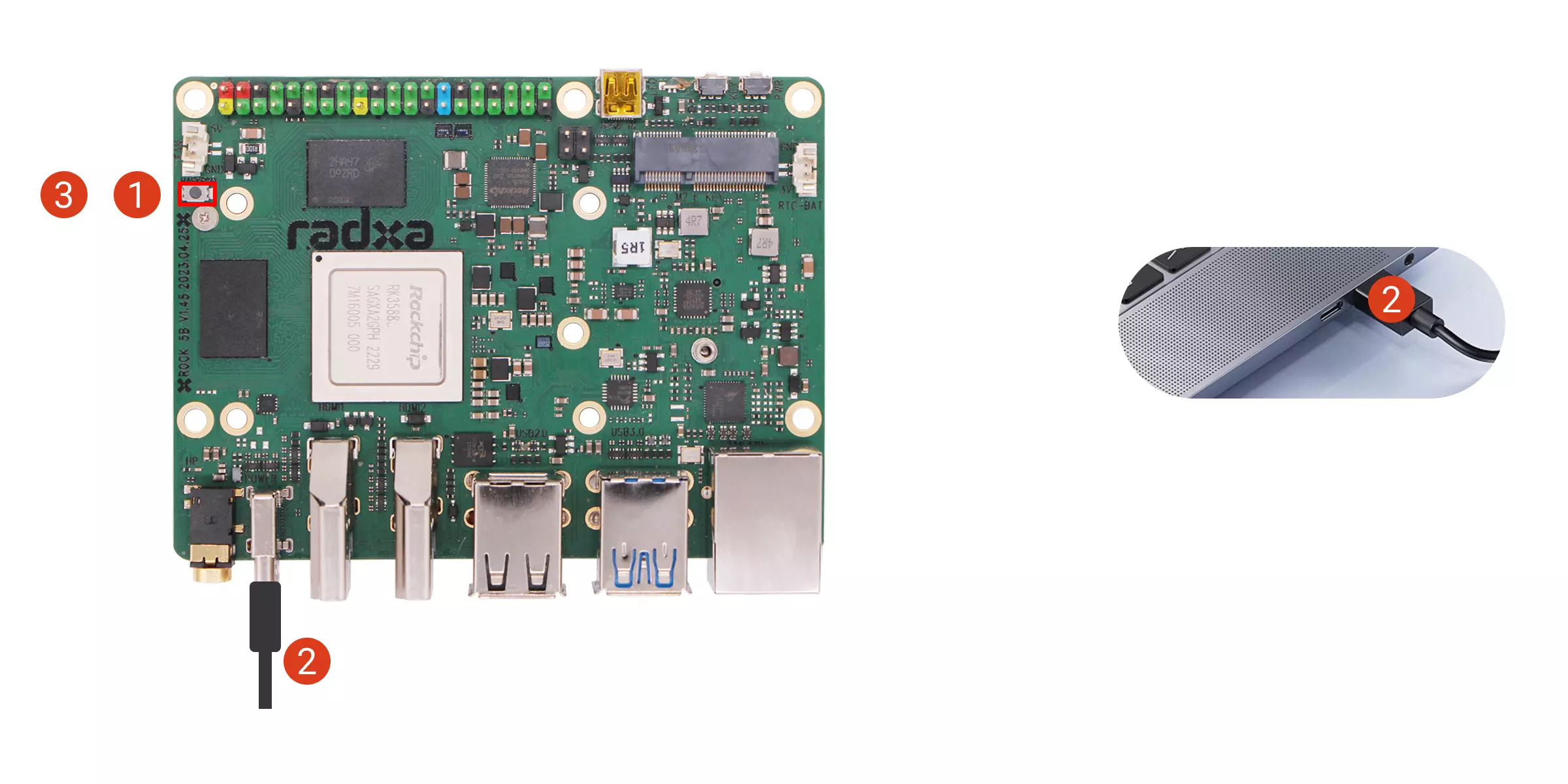

Our board has a dedicated Maskrom button. To enter Maskrom mode, press and hold the Maskrom button before powering on the board. The system will detect the button press and automatically enter Maskrom mode.
- ROCK 5B+
- ROCK 5B
Detailed steps:
① : Press and hold the Maskrom button
② : Power on the board using the power adapter
③ : Release the Maskrom button
④ : Connect the board's OTG port to your computer's USB port using a data cable
Detailed steps:
② : Connect the board's OTG/power supply interface to your computer's USB port using a data cable
