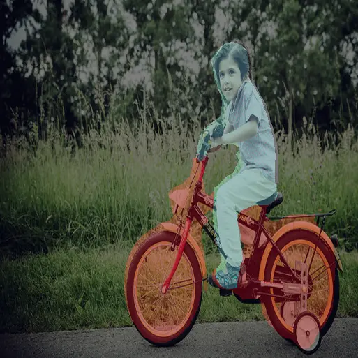

./rknn_deeplabv3_demo ./model/deeplab-v3-plus-mobilenet-v2.rknn ./model/test_image.jpg
$ ./rknn_deeplabv3_demo ./model/deeplab-v3-plus-mobilenet-v2.rknn ./model/test_image.jpg
arm_release_ver: g24p0-00eac0, rk_so_ver: 3
model input num: 1, output num: 1
input tensors:
index=0, name=sub_7:0, n_dims=4, dims=[1, 513, 513, 3], n_elems=789507, size=789507, fmt=NHWC, type=INT8, qnt_type=AFFINE, zp=0, scale=0.007843
output tensors:
index=0, name=logits/semantic/BiasAdd:0, n_dims=4, dims=[1, 65, 65, 21], n_elems=88725, size=88725, fmt=NCHW, type=INT8, qnt_type=AFFINE, zp=-109, scale=0.100937
model is NHWC input fmt
model input height=513, width=513, channel=3
origin size=513x513 crop size=512x512
input image: 513 x 513, subsampling: 4:4:4, colorspace: YCbCr, orientation: 1
output_mems-> fd = 12, offset = 0, size = 354900
post_buf_mem-> fd = 13, offset = 0, size = 263169
rknn_run
write_image path: out.png width=513 height=513 channel=3 data=0x33a04740
Result Preview​

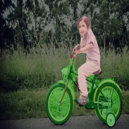

python deeplabv3.py --model_path ../model/deeplab-v3-plus-mobilenet-v2.rknn --target ${TARGET_PLATFORM}
$ python deeplabv3.py --model_path ../model/deeplab-v3-plus-mobilenet-v2.rknn --target rk3588
done
--> Init runtime environment
done
--> Running model
--> done
Result Preview​
