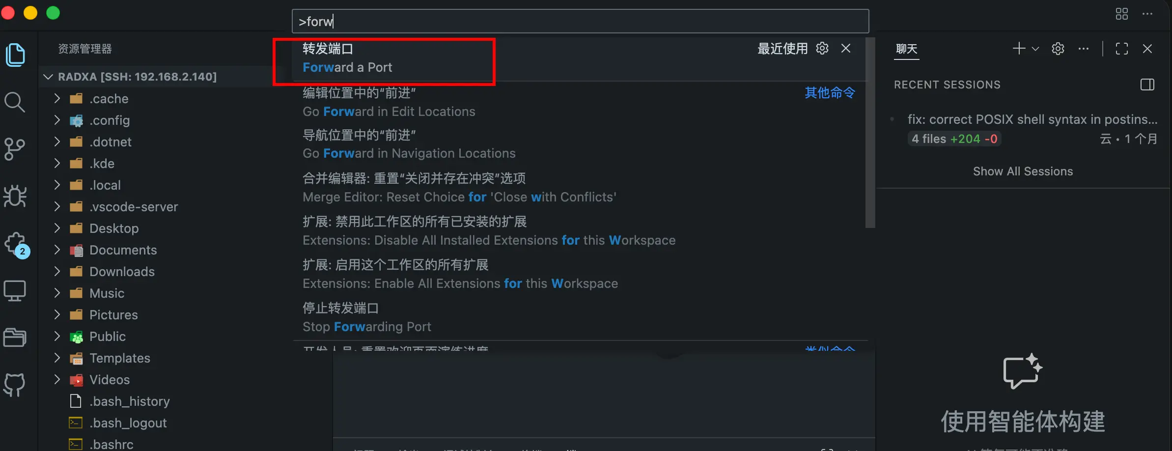

Port forwarding
When a web service or debug service is running on the SBC, you can use VS Code Port Forwarding to forward the port to your local machine, making it easy to access from a browser or debugging tools.
Port forwarding
