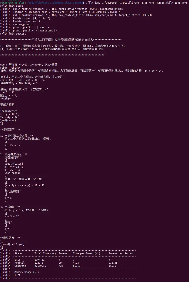

Performance Analysis
For the math problem: "Solve the equations x + y = 12, 2x + 4y = 34, find the values of x and y",
Performance on RK3588 reaches 15.36 tokens/s:
Stage | Total Time (ms) | Tokens | Time per Token (ms) | Tokens per Second |
Prefill | 122.70 | 29 | 4.23 | 236.35 |
Generate | 27539.16 | 423 | 65.10 | 15.36 |
On RK3582, the performance reaches 10.61 tokens/s:
Prefill | 599.71 | 81 | 7.4 | 135.07 |
Generate | 76866.41 | 851 | 94.25 | 10.61 |
