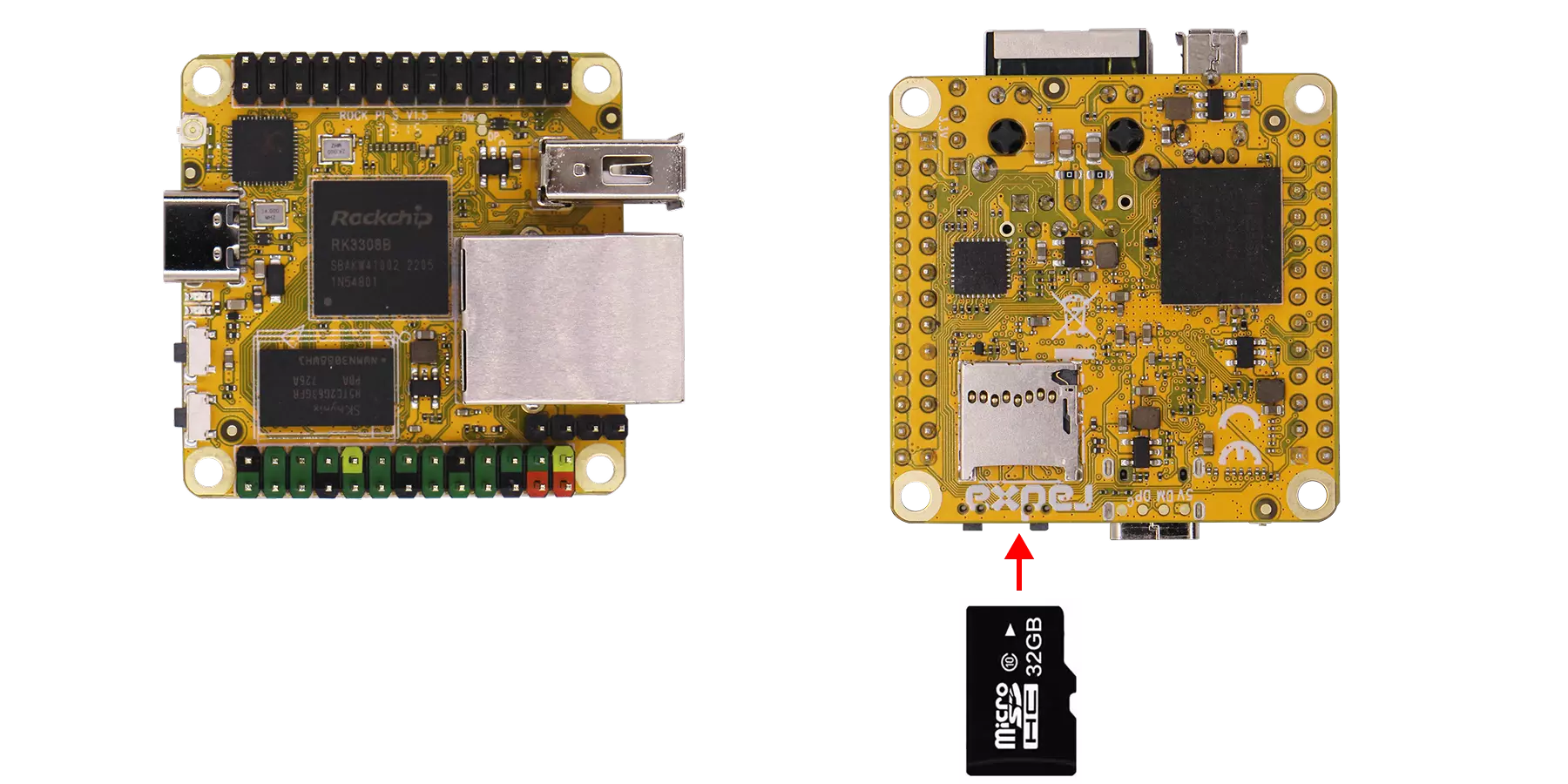

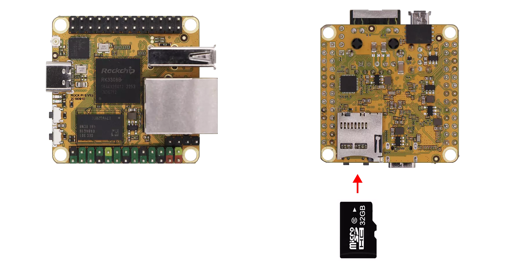

Booting the System​
After completing the system image installation:
  1. Remove the microSD card from the card reader
  2. Insert the card into the microSD card slot on the mainboard
  3. Power on the system using either:
    • A 5V Type-C power adapter, or
    • A Type-C to Type-A cable connected to a PC
After the system boots up, the power indicator will stay lit, and the status (user) LED will blink.
