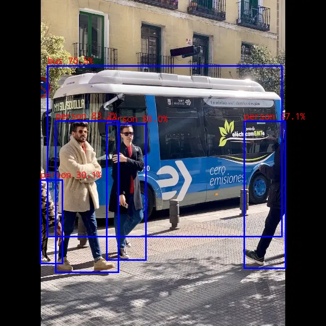

write_image path: out.png width=640 height=640 channel=3 data=0x892c940
  • person @ (...) 0.880 shows the detected class, bounding box, and confidence score.
  • write_image path: out.png indicates that the bounding boxes were drawn and saved to out.png.
The current directory retains the inference output out.png:
