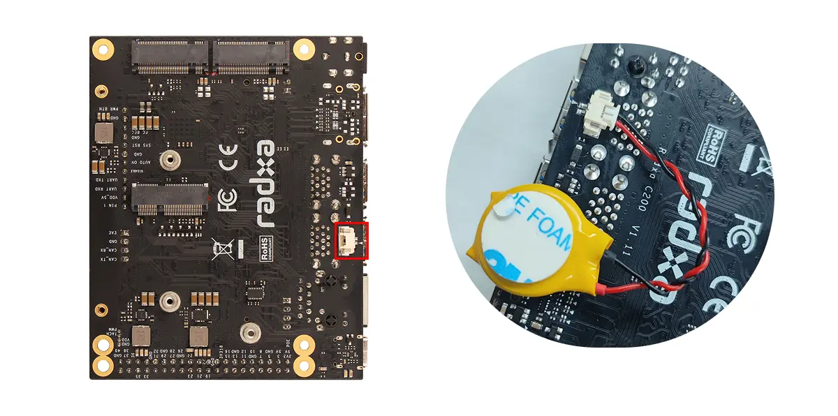

The onboard RTC battery connector on Radxa NX4 Development Kit provides a stable clock source, ensuring the system can keep accurate time even after power is removed.
Connector specifications​
  • Connector type: 2-Pin 1.25 mm Connector
  • Battery type: CR2032
  • Battery voltage: 3.3V
Hardware connection​
When connecting an RTC battery to Radxa NX4 Development Kit, pay attention to the polarity and operating voltage to avoid damaging Radxa NX4 Development Kit.
