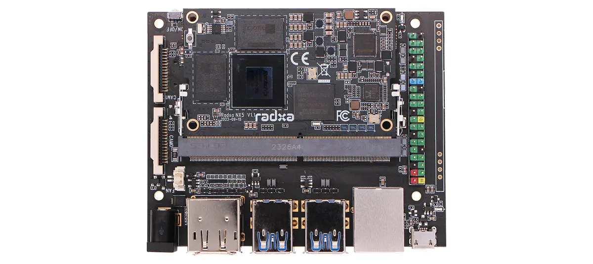

Product Image​
The Radxa NX5 Development Kit consists of the Radxa NX5 compute module and Radxa NX5 IO Board, providing a complete hardware development platform for quick validation of compute module functionality, performance evaluation, and prototype system building to help users efficiently complete development and solution verification.
Note: The Radxa NX5 IO Board needs to be purchased separately by the user.

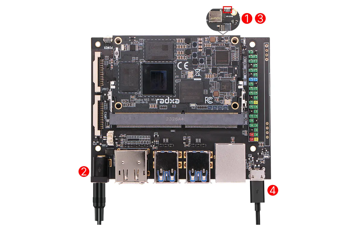

Our board features a dedicated Maskrom button. To enter Maskrom mode, press and hold the Maskrom button before powering on the board. The system will detect the button press and automatically enter Maskrom mode.
Detailed steps:
① : Press and hold the Maskrom button
② : Power on the board using the power adapter
③ : Release the Maskrom button
④ : Connect the board's OTG port to your computer's USB port using a data cable
nx5
After the board enters Maskrom mode, you can use the RKDevTool to verify the mode.
