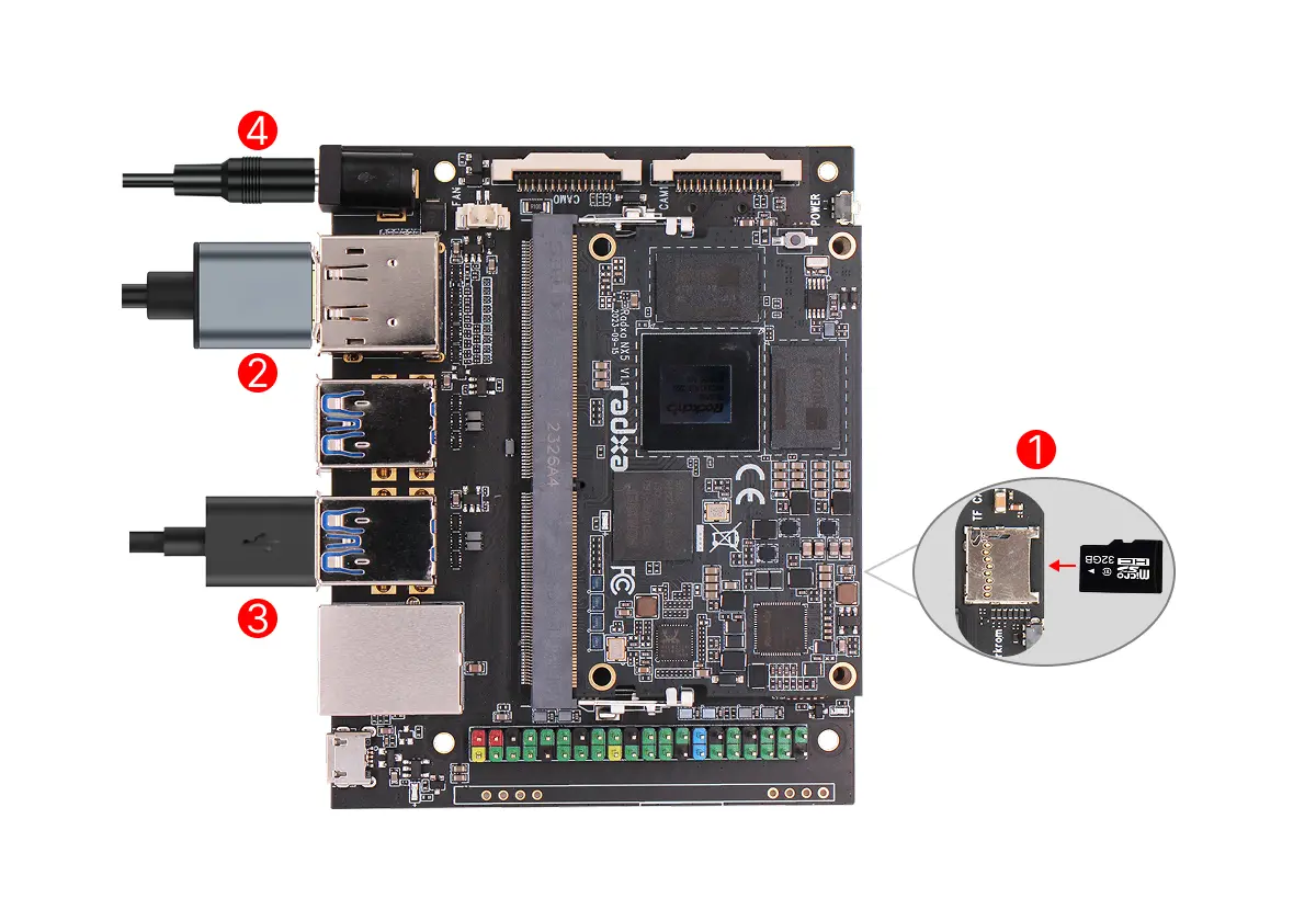

Boot the System​
①: Insert the microSD card into the microSD card slot
②: Connect the display and the board using an HDMI or DP cable
③: Connect a mouse or keyboard using the USB-A interface
④: Power the board using a 5V DC power adapter
If the board is powered normally, the Radxa NX5 IO Board power indicator LED will light up green. The monitor will display the Android system desktop.
Note: The Radxa NX5 IO Board system status indicator LED will not light up.
