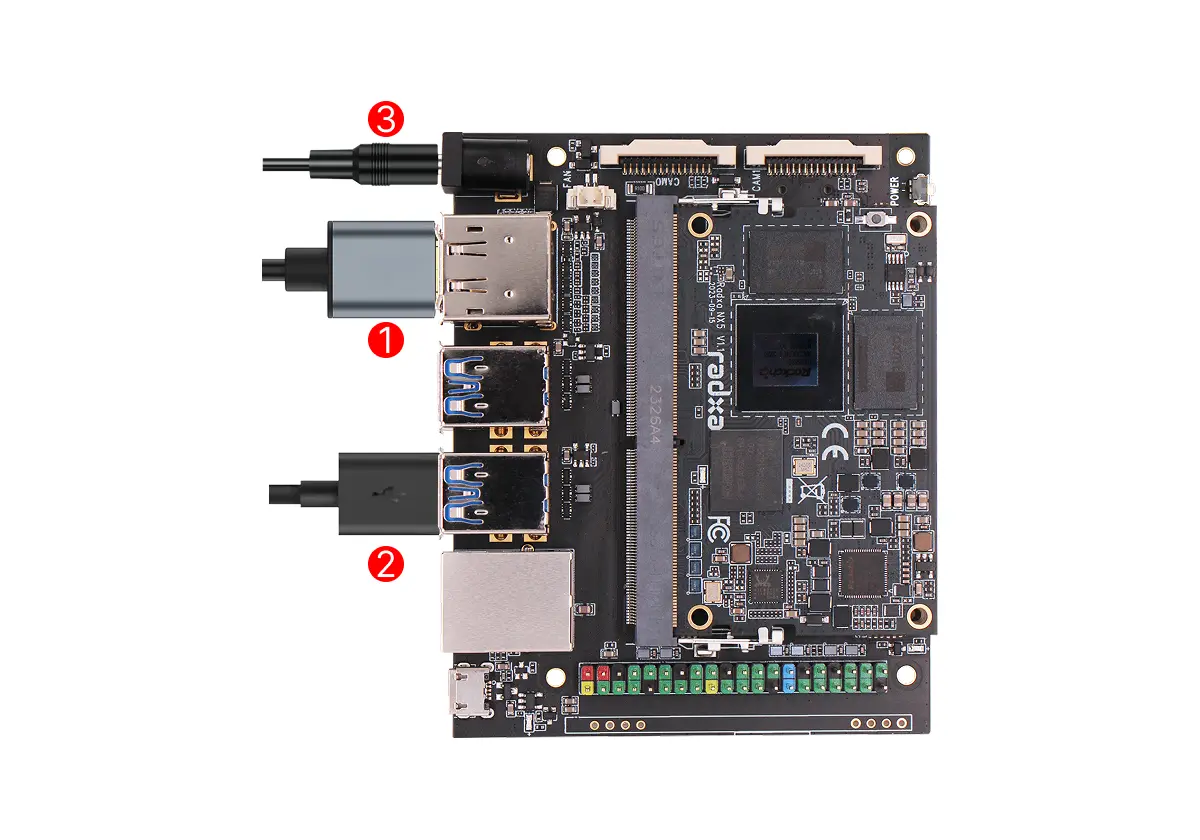

Boot the System​
After the system installation is complete, connect the HDMI display, then re-plug the power adapter to boot the system.
①: Connect the display and the board using an HDMI or DP cable
②: Connect a mouse or keyboard using the USB-A interface
③: Power the board using a 5V DC power adapter
If the board is powered normally, the Radxa NX5 system indicator LED and the Radxa NX5 IO Board power indicator LED will light up green. If the system boots normally, the Radxa NX5 system indicator LED will blink green, and the Radxa NX5 IO Board status indicator LED will blink blue.
