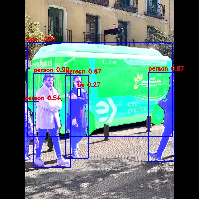

bus @ (87 137 553 439) 0.911
person @ (109 236 226 534) 0.900
person @ (211 241 283 508) 0.869
person @ (476 234 559 519) 0.866
person @ (79 327 125 514) 0.540
tie @ (248 284 259 310) 0.274
write_image path: out.png width=640 height=640 channel=3 data=0xaaab07e88330
Result Preview​
Python API​
Activate the virtual environment​
conda activate rknn
Run the Example​
Copy the related files to the device and run the following commands.
python yolov8_seg.py --model_path ../model/yolov8_seg.rknn --target ${TARGET_PLATFORM} --img_save
$ python yolov8_seg.py --model_path ../model/yolov8_seg.rknn --target rk3588 --img_save
--> Init runtime environment
done
Model-../model/yolov8_seg.rknn is rknn model, starting val
IMG: bus.jpg

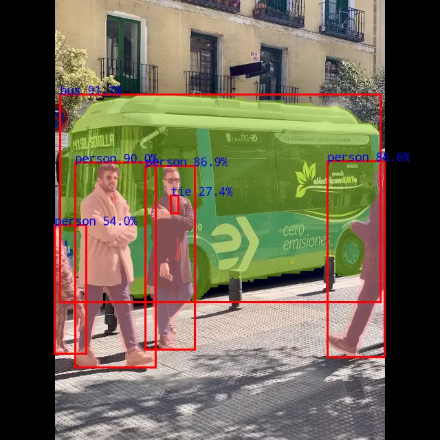

person @ (108 236 227 537) 0.900
person @ (477 232 559 519) 0.866
The segmentation results have been saved to ./result/bus.jpg
Result Preview​
